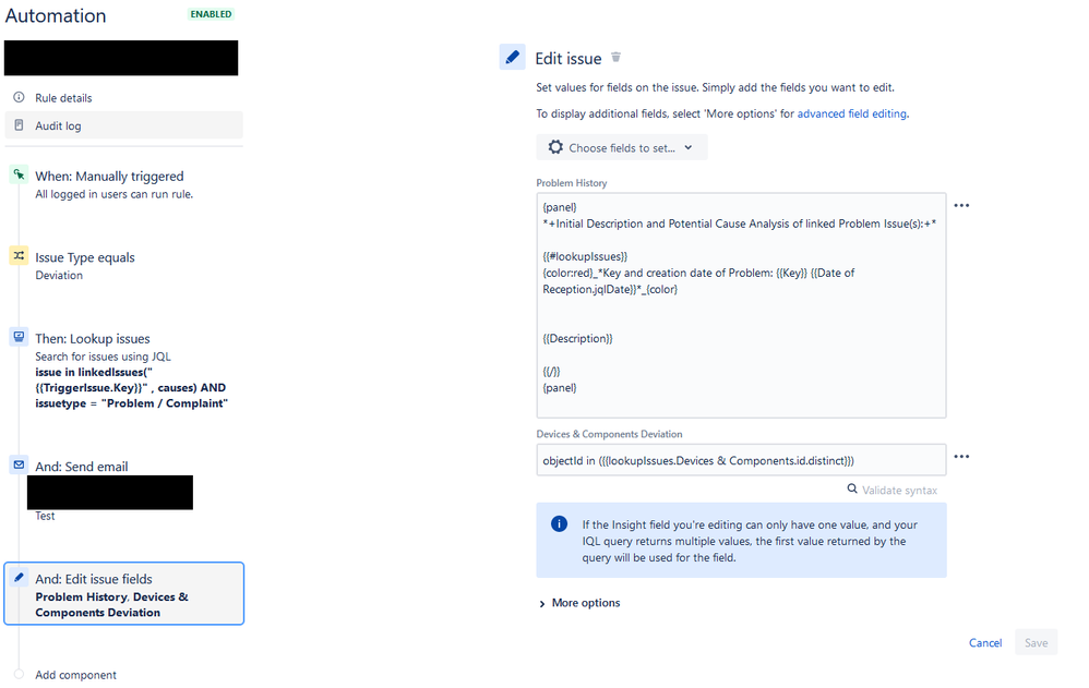

Hello all,
I am trying to populate an Insight field with objects gathered from multiple linked jira issues. I can retrieve said objects via {{lookupIssues.Devices & Components.id.distinct}}. It returns a list which looks like this  "[95], [96], [92], [1844], [99], [100]".
It seems that the brackets are causing some problems here. When I put in "objectid in (95, 96)" to populate the insight field it works. Can someone tell me how to solve this? Maybe some way to remove the brackets or convert the list to a string?
Any help appreciated! Thanks!

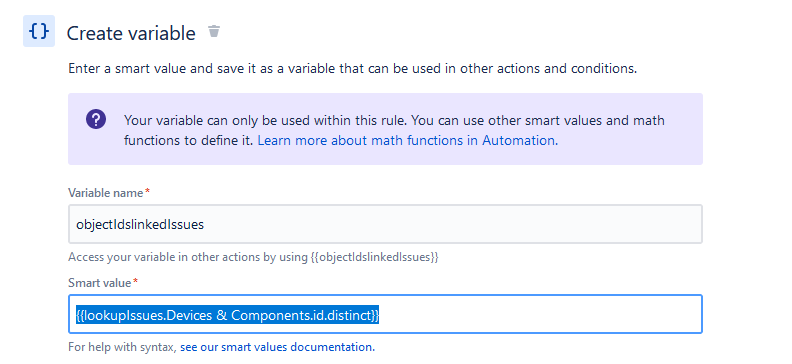

For future strugglers with a similar problem, here is the solution:
  • You can convert the list into a string by creating a variable
  • afterwards you can use string operations:
    {{objectIdslinkedIssues.remove("[").remove("]")}} removes the brackets from the string and makes it readable for the "objectid in (some string)" function

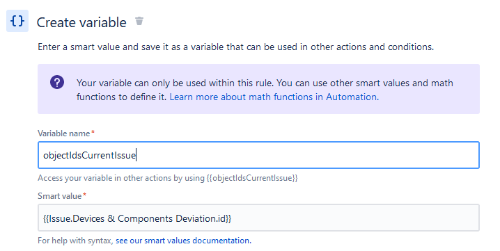

  • if you dont want to overwrite the values in the current insight custom field you can create a second variable
  • via the concat function you end up with the rather nasty looking line:
    objectId in ({{objectIdslinkedIssues.concat(", ").concat(objectIdsCurrentIssue).remove("[").remove("]")}}) Note: You have to add an additional concat to insert a ", " between the two strings
