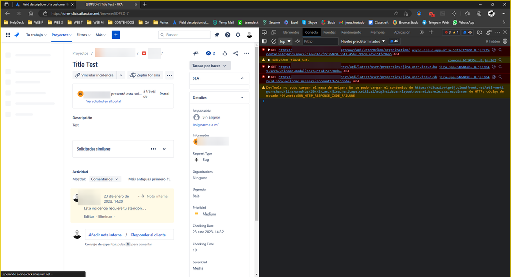

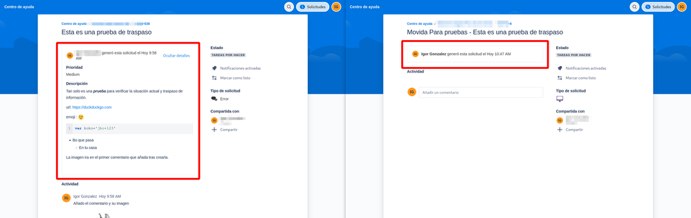

Field description of a customer ticket through portal Service Desk dissapears after moving or cloning to another project.
Both projects have the same description field.
  1. The client create a ticket in Service Dek Proyect
  2. I move or clone to another project with the same fields (specificaly description is the same), and the type of proyect is the same (Service Desk proyect)
  3. In the client portal dissapears the description

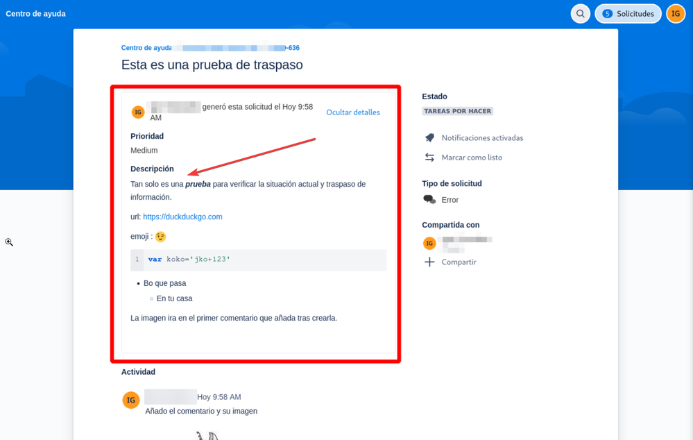

Screenshot of client portal view with description

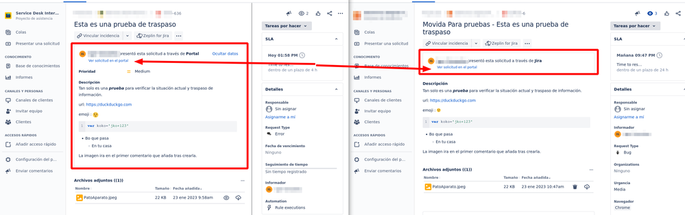

Screenshot from Jira proyect
You see in the left the ticket before move or clone and in the right after move.
Screenshot of the portal client view (same in the left before move / clone in the right after move.
The description dissapears
I add other screenshot with the fields of the projects where you can see the same type of descrption field.

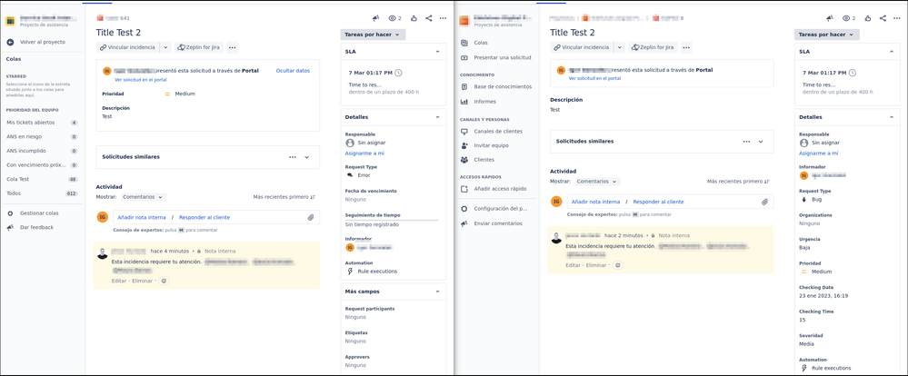

- Can you try to do the same but with a very simple Description like "TEST"?
Yes in the screenshots before you have (form one to five is the process, the rest is more details)

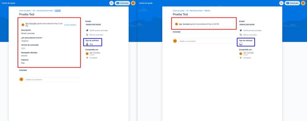

I'm analyzing your screens and I see one difference. Are you sure that you're checking a right issue? The request types are different:
jesus.hurtado
January 23, 2023
jesus.hurtado
January 23, 2023
Excuse me, my mistake.
We have tried several ways, I may have taken the wrong photo, but the fact is that whatever type of ticket you choose, it always fails.
I add capture with the correct photos above.

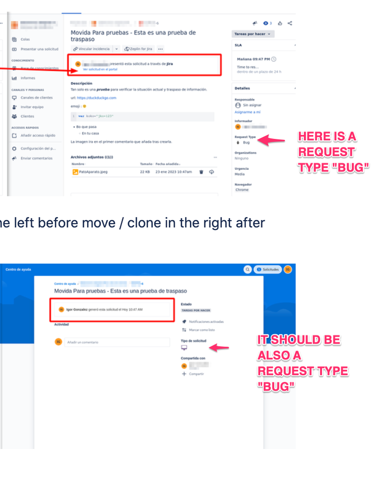

1. I noticed that moving issues doesn't affect the Request type field. I see that is a feature request for it: JSDCLOUD-3613. Did you try to go to the issue view and click in and out for these fields?

Finally, we have carried out the same test with 2 Service Desks A and B with the exact same configuration and with the same description fields, when moving from A to B the field disappears.
But all this, to be clear, from the point of view of the client from the PORTAL (not from JDS). Our client can't see the description when we move the tickets, it's a big problem.
Best regards
jesus.hurtado
January 24, 2023
Also...
From the last test mentioned in the previous comment, we have detected another failure that may have something to do with it.
When moving the ticket between the two, what is described above happens, the description disappears... but the type of the ticket also changes. Switch from Error to Support
Before, I thought it was my mistake that I confused the two tickets, but no, that's what happens, it changes by itself and I repeat, the two projects in this test are exactly equals.

What do you mean by exactly equal?
Do they share the same configuration schemes? Do they have the same request types and are these request types associated with the corresponding issue types? It's really strange that you move an issue (issue type) and this issue type is associated with another request type. Most likely this issue type is associated to more that one request types.

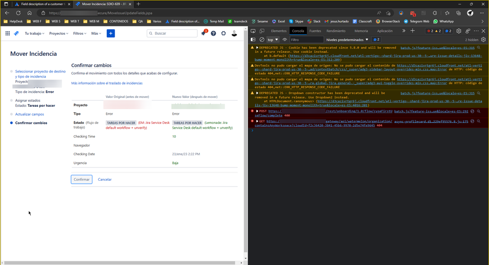

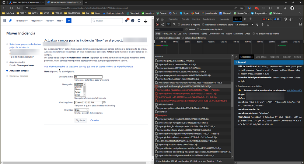

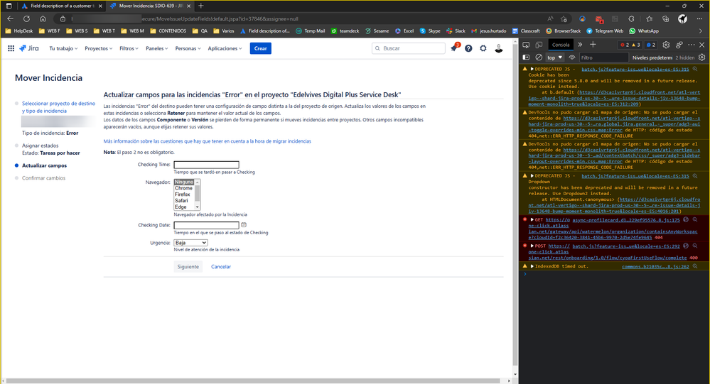

When you move issues manually you:
  • Select the project
  • Select the issue type
  • Map the statuses
  • Update fields (in case they have different contexts)
  • Confirm the changes
When all the above happens the issue is moved to the new project and the request type is left blank. If you see a value there, then most likely there is an automation somewhere that's get triggered. So let's solve this thing first:

I have manage to reproduce your problem:
  1. Open an issue on your service management project
  2. Move the issue to the new project
  3. View the issue immediately on the portal before making any other changes
The description will not be visible. This is due to the fact that your moved issue type doesn't have any request type. This is the same that @Kate Pawlak _Appsvio_ told you to one of her replies. Once you choose a request type the description will be there!
