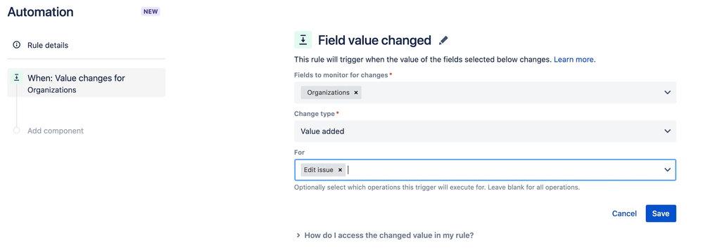

Hi Everyone,
I would like to inform you that we have updated the "Field Value Changed" trigger in A4J (automation) to listen and understand different types of changes: Value added, value deleted, any changes to the field. One of these types can be selected as filter when adding this trigger to an automation rule. Now automation rules can differentiate different change types. For example, rules can now be triggered when an Organization or a Participant is added to an issue.
