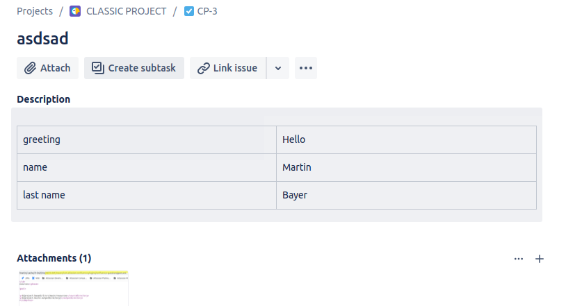

I prepared issue with a table:

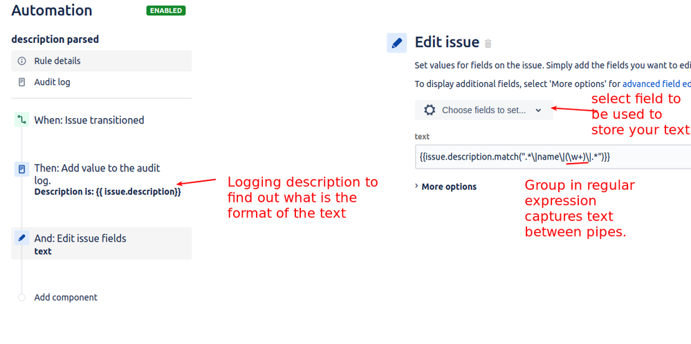

And I prepared an automation with following setup:
I logged my description to find out what is its format and it was:
|greeting|Hello| |name|Martin| |last name|Bayer|
 I hope it will help... :)
Like Olof Nysten likes this
Olof Nysten
February 22, 2021
Thank you very much! That was exactly it. I have experimented with expressions like that but never found the solution.

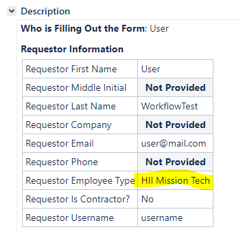

@Martin Bayer _MoroSystems_ s_r_o__ I have a similar situation but I am just not able to grab the data, my table looks like this:
I need to grab the data that is highlighted so my text looks like this:
{{issue.description.match(".*|Requestor Employee Type|(\S+)|.*")}}
