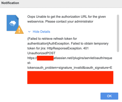

However, the Microstrategy configuration always gives us this error:
Does anybody know how to fix it?

Did you check this info about 401 from the docs?
"MicroStrategy supports deploying the MicroStrategy Web Server on IIS, but does not support deploying the Community Connector Server on IIS. To avoid the HTTP 401 Unauthorized error, refer to KB483651. "
Source: https://www2.microstrategy.com/producthelp/Current/WebAdmin/WebHelp/Lang_1033/Content/Deploy_Connectors_to_MicroStrategy.htm

Our MSTR is running on Tomcat, but we have a backup on IIS.
Is this IIS setup required too for our case?
