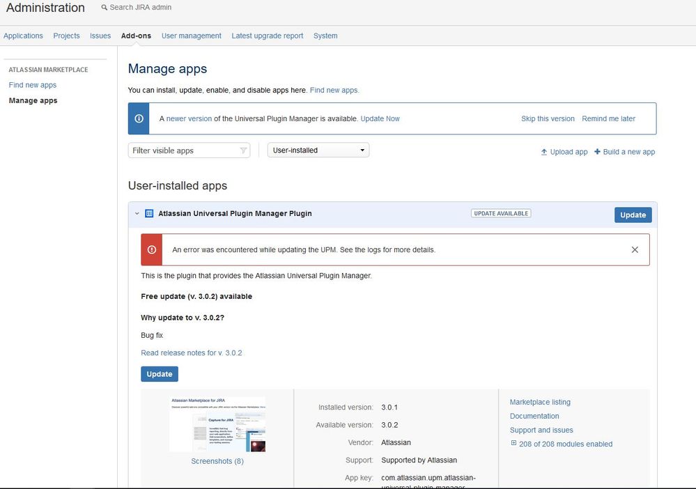

I have problem to update universal plugin manager. I try to update on version v. 3.0.2, but i get error: "An error was encountered while updating the UPM. See the logs for more details." Can you please help me to solve this problem, so i can update to new version.

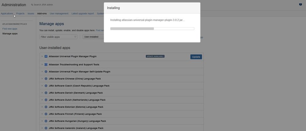

Denis
February 11, 2019
Screenshot of error i get from Jira

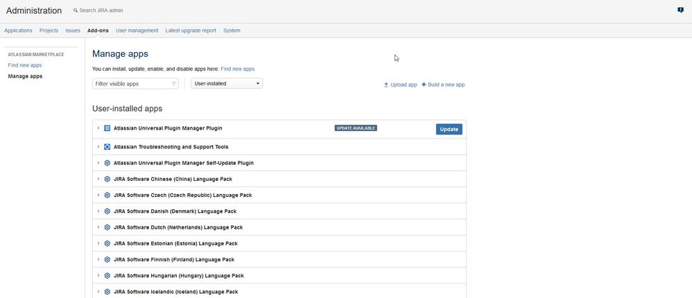

Denis
February 11, 2019
I try that, and nothing happens. I will attach pictures.
