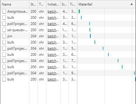

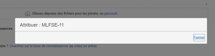

Hi,
I have a problem when I try to assign me an issue.
We have installed a reverse proxy for a instance of Jira Service Desk. If I use the https links, my popup of assignement doesn't closed and the refresh isn't made so I had to make it manually.  And in my dev console, I don't have any error.
If I use directly the url of the tomcat (without https, only http) I haven't any error, the pop up is closing itself and the refresh is made.
Any one have a solution or the beginning of solution ?
