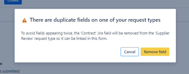

×I have my request type created and am working on my form. When I attach the form to the request type and try to save the form, I get this message "There are duplicate fields on one of your request types". Have verified 3 times that there are no duplicate fields. I even created a new request type, added only 1 field to it, attached the request type to the form, and tried to save the form. I get the same error message.
I created the initial request type and form a few months ago. no problems then. I needed to update some field names on the form today and this is when the error is happening. I don't know what to do. Does anyone have any suggestions or thoughts on this error?

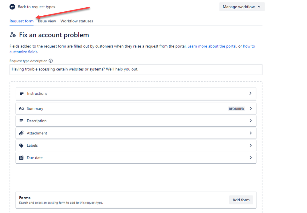

Lastly, If your FORM's elements are properly mapped to issue fields for your request type, you need to also make sure that you don't include the same field in your request type's "Request form" tab.

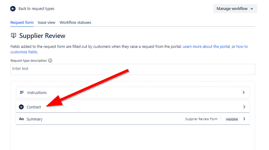

Here is my request type:

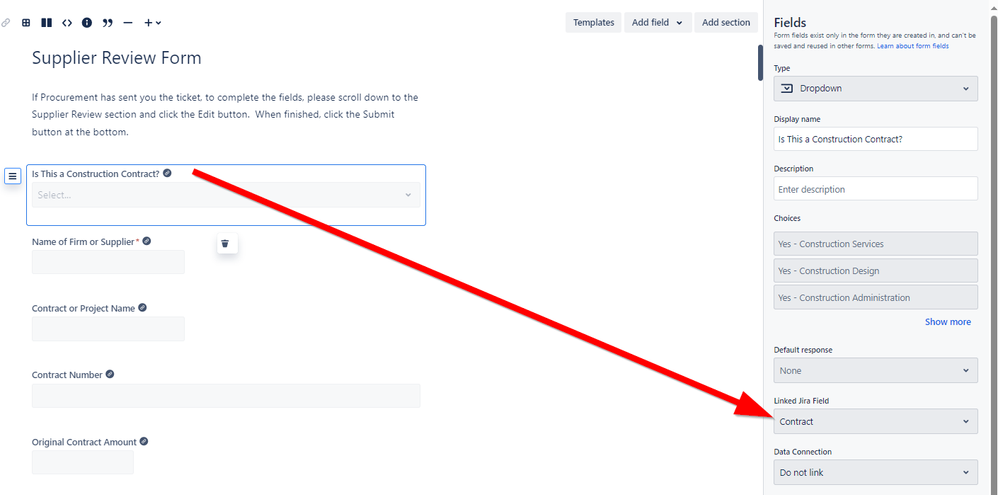

Here is the form that I have set up. It shows that the first form field is linked to the request type field.

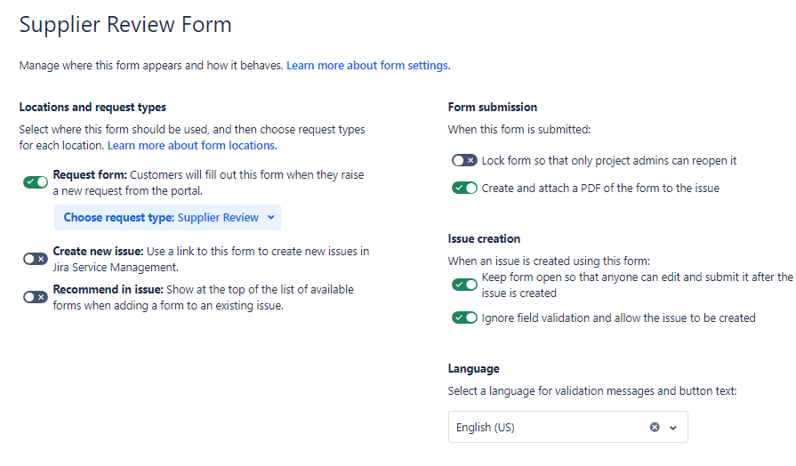

Here are the form setting page
Here is the error that I'm getting when clicking Save.
@Joseph Chung Yin what am I doing wrong? I've set up several forms this way, with no problem, but that was a few months ago. Was there a JSM update that modified the way forms and request types work together?

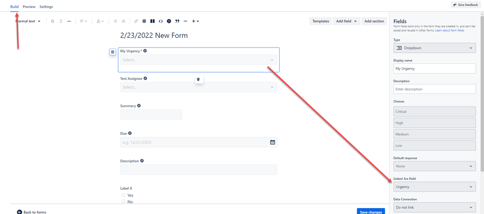

Here you go:
Open your FORM configuration - Using the Build tab on mapping an element to an actual Jira issue field
Here is link in the FORMs documentation on how to link element (form field) to an actual issue field used in your JSM issue - https://support.atlassian.com/jira-service-management-cloud/docs/link-a-form-field-to-a-jira-field/
