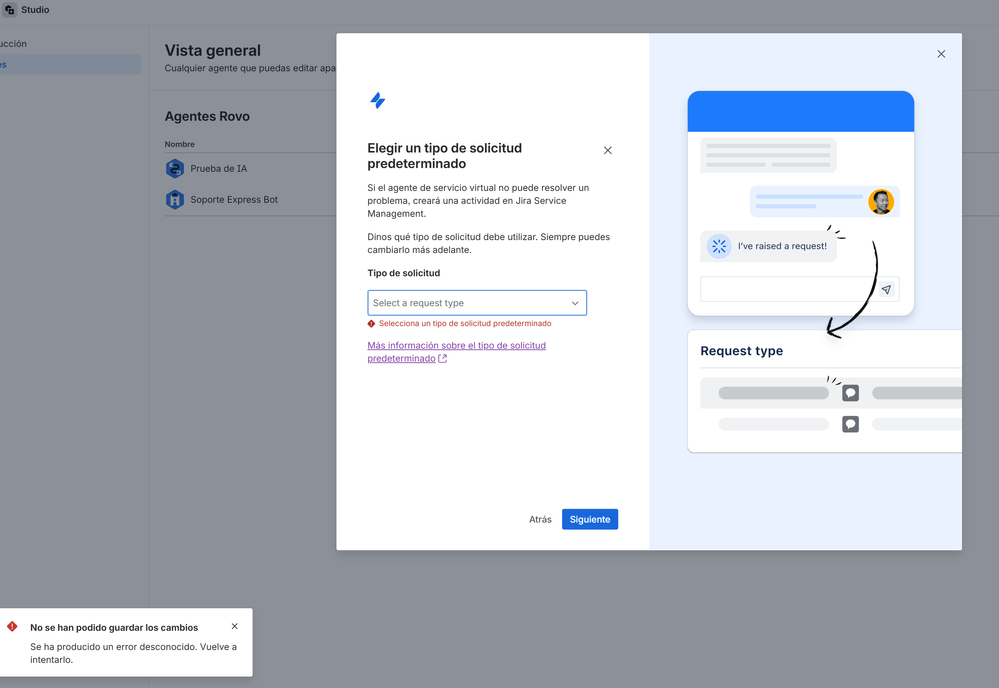

I'm trying to create a virtual service agent, to create a widget chat in Jira Service Management. A Rovo agent do not work for this intend.
When I try to create the agent, it is required to select a default type of request for the agent. Whenever I select a request, an error saying an unknown error had happen appear.  I have try all of the requests of my space and no one is able to be selected. I have also created a new request, I have remove from it all the fields that can be removed and it still don't work. Do someone know why this error is happening?

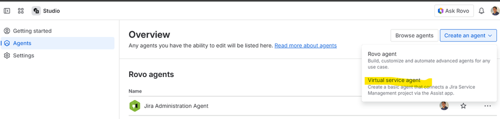

Doods Perea
January 19, 2026
Hi Miguel - in your Rovo Studio, you have the option to create a Rovo agent or a Virtual service agent.
Configure and test.  Once done, go to your JSM space, "Channels & self service >> Portal".  In the Portal configuration tab, disable the "Display a Rovo agent on this portal".

Hi Doods and thank you for your answer,
Going back to my original question. I have tried to create the virtual agent, but it ask me to select a default request for when the bot is unable to solve the issue. I have try all the requests in my project and create some empty ones, but all of them are rejected with an unknown error. The screenshot is in spanish, but the error literally translate to: "The changes could not be saved. An unknown error has occurred. Please try again."

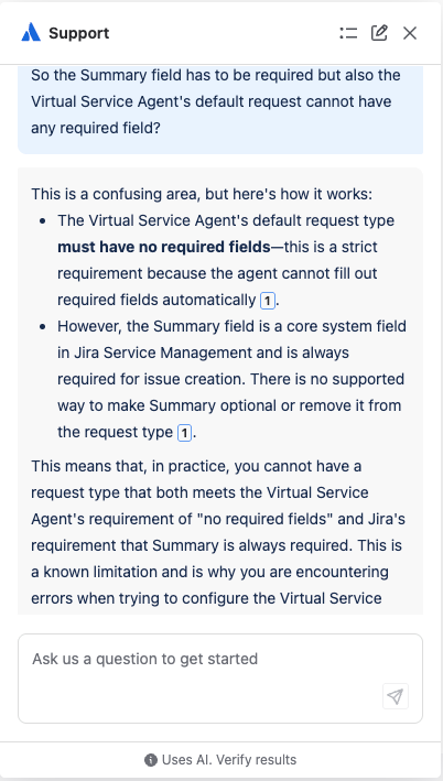

Hi Miguel - I am unable to reverse engineer your issue with the error when mapping the Request Type.  However, make sure that:
  1. Before even working on the Virtual Service Agent (VSA), you have at least one Request Type (e.g. Report a Jira Incident) that is mapped to a Work Type (Incident).  This Request Type must be visible from your Portal.
  2. In the VSA configuration, it is a requirement to select a Request Type.  This is because the VSA will create a Work Item when the customer's inquiry is not answered successfully.
  3. If you are unable to complete step #2, create a new VSA, then configure.
Here are my tips re using Rovo Agent vs VSA in the JSM Portal:
  1. Rovo Agent is easier to configure and more robust.  It can also create a work item based on the conversation with the customer.  That said, creating a work item is faster with VSA because of its mapping to a Request Type.
  2. If VSA is preferred, configure your Request Type to be as generic as possible.  This is not trivial but will address the limitation of the VSA regarding its mapping with a Request Type. For example:
    1. "Create a Task" Request Type, map it to Work Type "Task".
    2. In the VSA >> Identity page, select the "Create a Task" Request Type.
    3. In the VSA >> Intents, your Flow should ask if the task to be created is of work type Incident, or Service Request, or others in your JSM space's Work Types page.
    4. If for example, the customer selected "Incident", the VSA will create the Task.
    5. Have an Automation Rule that will update the Work Type of the newly created Work Item from Task to Incident.  The rule must also select the matching Request Type.
I hope this helps!
