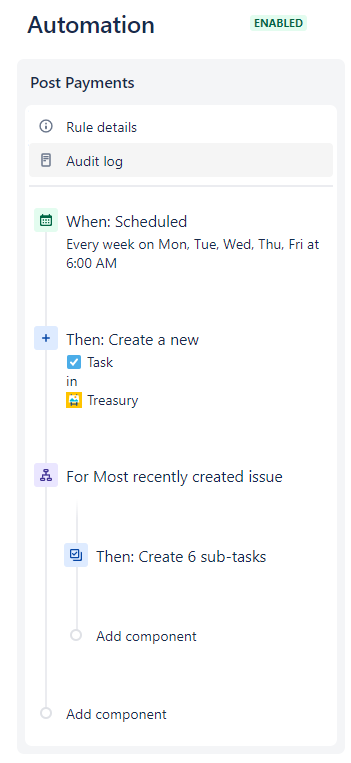

I have a couple automations in a JSM project that create a task and then add subtasks to that most recently created issue. I am receiving the following error:
Create subtasks
Some sub-tasks could not be created:
1: The issue type selected is invalid. (issuetype), Issues with this Issue Type must be created in the same project as the parent. (project), 2: The issue type selected is invalid. (issuetype), Issues with this Issue Type must be created in the same project as the parent. (project), 3: The issue type selected is invalid. (issuetype), Issues with this Issue Type must be created in the same project as the parent. (project), 4: The issue type selected is invalid. (issuetype), Issues with this Issue Type must be created in the same project as the parent. (project), 5: The issue type selected is invalid. (issuetype), Issues with this Issue Type must be created in the same project as the parent. (project), 6: The issue type selected is invalid. (issuetype), Issues with this Issue Type must be created in the same project as the parent. (project)

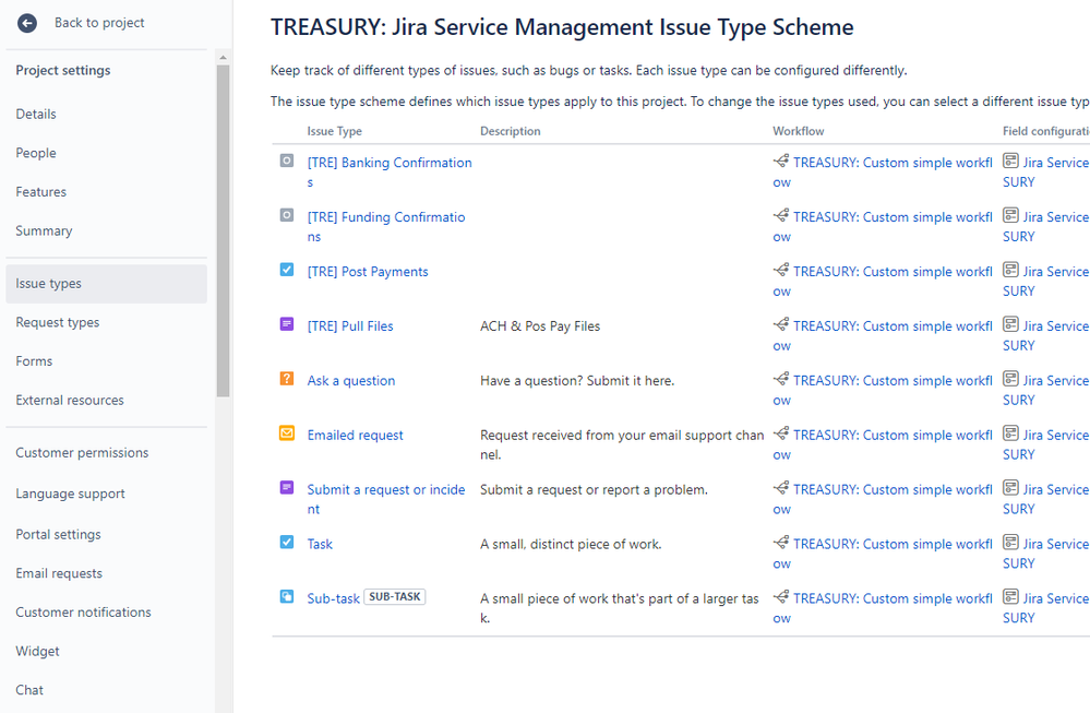

  1. I have checked that the task and sub-task are part of the issue type scheme for this project & that sub-task is actually a sub-task: JSM- issue type scheme.png

Here is the automation example:

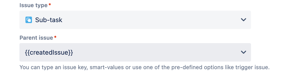

One common mistake that people do is what they used in the "Parent issue" parameter when creating sub-task (example image below).  It will be excellent that if you can provide us what you have in your rule configuration -
Best, Joseph Chung Yin

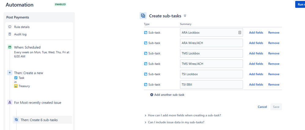

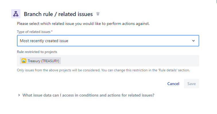

@Joseph Chung Yin @Kai Becker I'm on the cloud version, so I think mine might look different. Here is what sub-task creation looks like:
The branching rule for most recently created issue typically has worked to link the sub-tasks to the created task similar to how yours works in your screenshot.

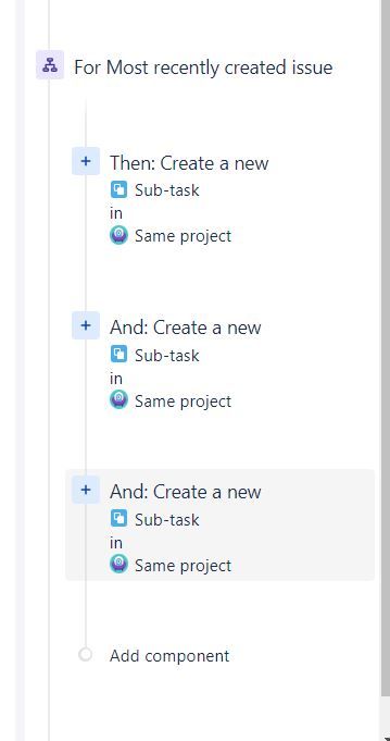

@Joseph Chung Yin
{{createdIssue}} in the Parent Issue box only works for the first subtask for me if they are separated out into subtasks with extra fields. When I try to do createdIssue it will throw an error for the next subtask in the branch since it tries to create that 2nd subtask as a subtask under the first subtask and that is not possible.

You chose the "Create Sub-tasks" action where as I had used "Create Issue" action and then selected  "Sub-task" in the Issue type drop down.
Two ways of achieving the same thing.

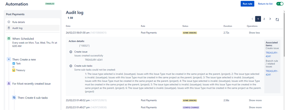

from your screenshots and explanations, everything looks ok. Could you please add a screenshot of the audit log of the rule and the sub task part?
I would like to reproduce this.
Amelia Giuliani
February 24, 2023
Here is the audit log:
It is creating the main task so I know that up to that point it's ok.
