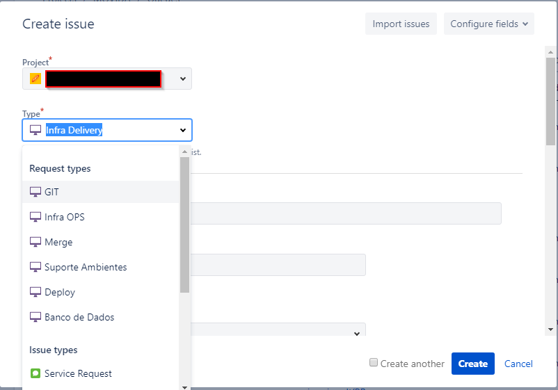

Hello All,
19th november I was reading this discussion because i had the same request from my customer.
At that date, it was not possible.
Today, when creating a ticket i got this options. They are the Request Types that are visible in the portal, and off course already associated to an Issue type. Seems they solve our request / need. (It works for me).  Yey!!!
