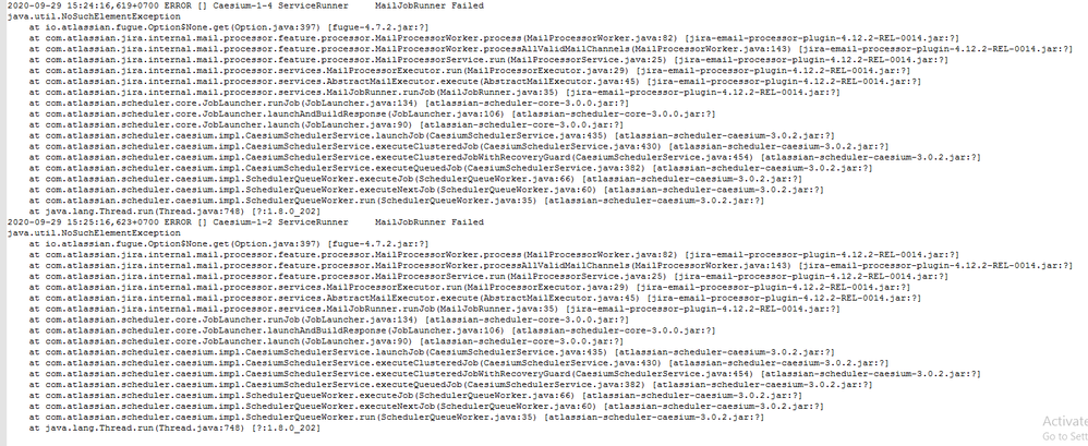

I have checked the logs files shown as below.
Could you kindly help us resolve it?

I understand that you imported some data from one Jira to another, and after that time it seems that Jira Service Desk is unable to process email requests.   Is the previous evaluation site still up and running?
I ask because the type of error that is generated is commonly seen where there exists a race condition to process these emails.  What I mean be that is that if you have two Jira Server instances that are setup to use the same email inbox for incoming messages, there can be situations where the message is getting processed by one Jira before the other Jira can complete the action.
Depending on the email connection method (POP vs IMAP), the message could be deleted from the inbox after it is processed by any Jira site (POP) OR the message could just be marked as unread once it is processed (IMAP).  But regardless of which protocol is being used, both can cause this kind of error of NoSuchElementException.
So that is what I would want to try to check first, see if perhaps there is another project or another Jira site that is connected to this same mailbox.  If you cannot ultimately find this other connection in Jira, then the next steps I would recommend would be to change the password on the email account, and then update your Jira email configuration to use this new password.  That is the most likely successful way to resolve this, if in fact this is caused by another site checking the same inbox at the same or shorter interval.

After trying with Imcoming mail (System), I found out some issues with email request, maybe it is a root cause.
Incoming mail returns errors on logs file:
Cannot create issue due to invalid license: [Sorry, you can't create any issues right now, as you need to have access to a Jira application to be able to create issues. To gain application access you need to be a member of a group assigned to an application.
Note: some emails successfully processed for tickets creation, some emails failed due to the above issue.
It is highly believed that there are some issues with the license of JSD. However, after checking the number of licensed users as well as checking permission scheme, it does not exceed.
And I have tried to creating new project and new email address for testing, but not retrieve email for tickets creation.
