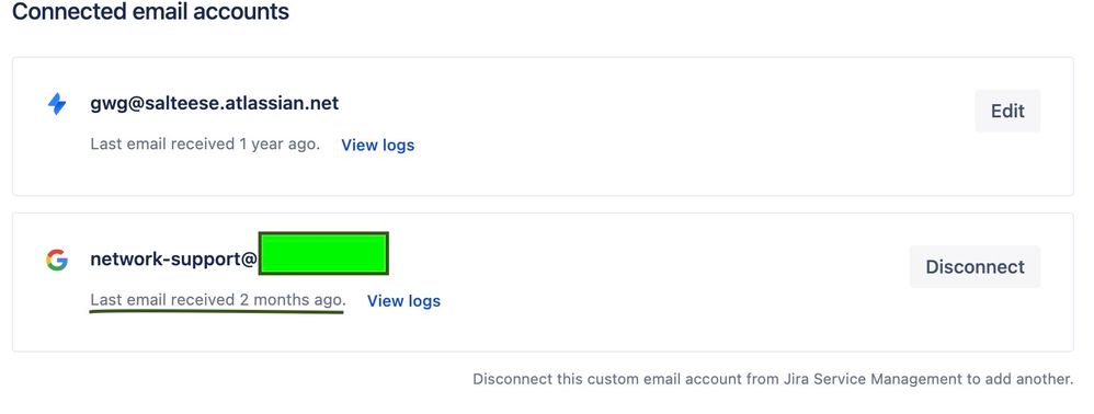

This is how it looks (the second email account). It says the last email was received 2 months ago, however, I tried sending an email to this account but no joy.

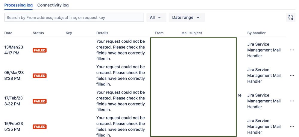

The logs are as below. I have checked the fields and only the Summary and Description fields are mandatory. Image 27-03-2023 at 12.06.jpeg
Jack Brickey
March 27, 2023
My guess is that you have one or more fields that are marked as required for your email request time. Please check that you only have the summary and description marked as required for your email request type.

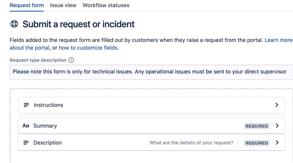

These two are the only required fields I can see.
Is there any way I can confirm this?
Thank you so much for your responses.

These are the fields that are required in the form. Unfortunately, the form isn't used when you are submitting an issue through the e-mail channel.
Please go to cog wheel > Issues > field configurations. Look for any fields that are marked as REQUIRED and note on which screen they are used. Most likely, there is a field there that is required that you didn't think about. It happened to me a while back, was not a fun night, having to re-create all those blocked issues from the log...
