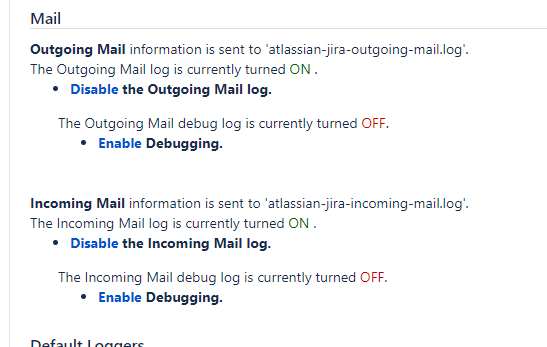

I guess the first step we'll have to tackle is to get some more information on what is going on on the system.
What kind of logging do you have enabled?
On the "logging en profiling" section for example you can enable debugging logs for incoming and outgoing email.
when looking at "mail" I can also see the com.atlassian.jira.mail.settings.MailSetting package that you could enable as debugging.
A lot more information can be found here: https://confluence.atlassian.com/adminjiraserver/logging-and-profiling-938847671.html

Dirk Ronsmans
October 14, 2020
With regards to the logging can you go on your base-url and then
/secure/admin/ViewLogging.jspa
That should take you to the correct options to enable further logging
