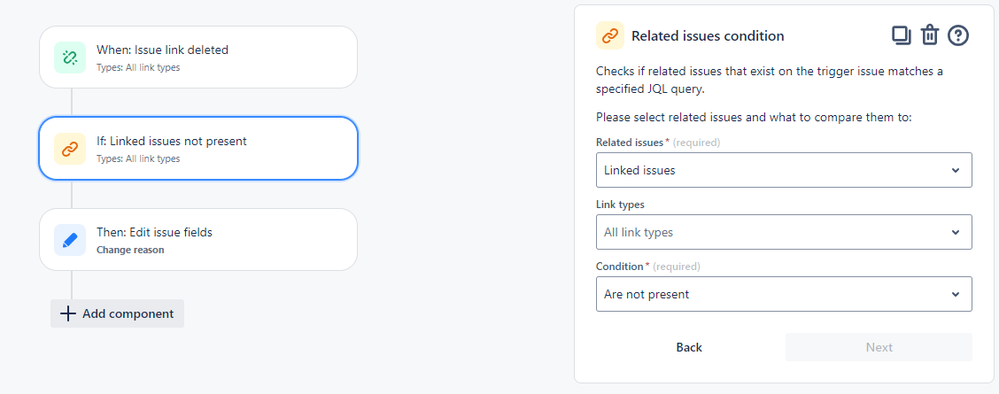

I am thinking create the rule with an Issue Link Deleted trigger as you mentioned.
The follow that up immediately with a Condition to see if there are any Linked issues.
Then update the issue.
See the example below.

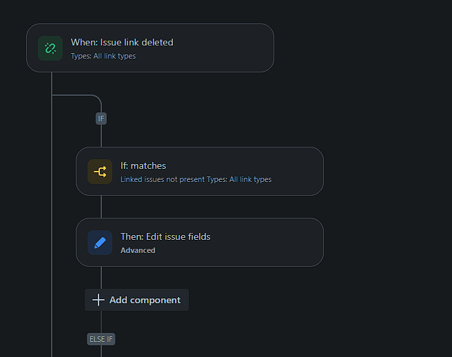

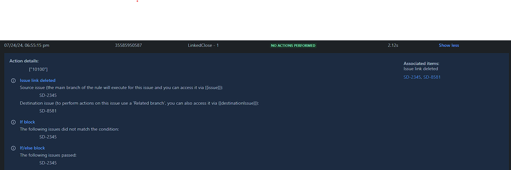

I do have similar rule running (screenshot attached).
Basically here, there are two types of linked issues
1. Issue (A) causes issue (B)
2. Issue (A) caused by issue (B).
So, if I link an issue where Issue(A) causes Issue(B), the rules works perfectly as expected and edits the custom field in Issue(A).

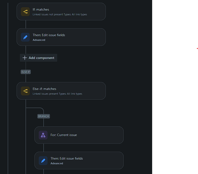

The issue is when I link an issue where Issue(A) is caused by Issue(B), rule says No Action Performed. If I tweak the automation, the rule runs successfully but it edits Issue(C) that is linked with Issue(B). I only want Issue(A) to be edited.
I am hereby attaching screenshots of the rule and the log.

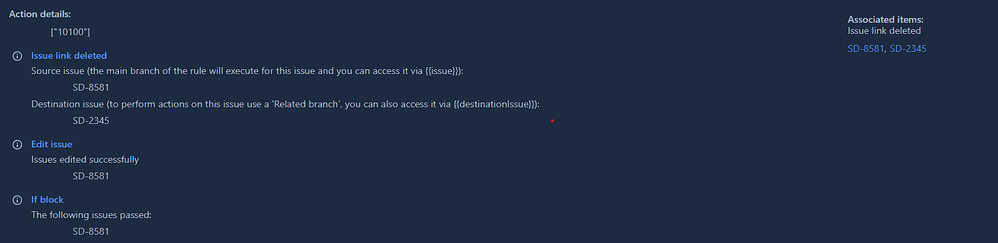

Here is the log: 8581 is the issue to be edited. (Rule Passed)

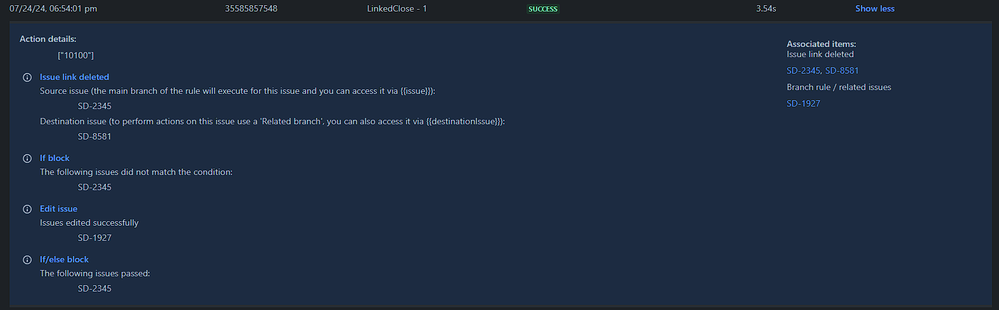

Here is the log: 8581 is the issue to be detected but the rule went to 2345 which is not the case. (No Actions Performed)unlink4.png
Here is the log: Strange thing is the rule passed but it went on to edit 1927 that is linked to 2345 which in turn is linked to 8581. So here, 8581 should be editedunlink5.png

I actually want to make sure the automation works on destination issue (SD-8581) when linked issues are deleted.

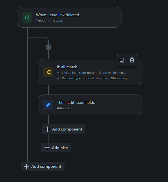

The following as suggested by @John Funk works fine when Issue(A) is the source.
In some case, the linked issues make Issue(B) as the source and this rule fails. I need to have a rule where Issue(A) irrespective of being a source or destination gets edited whenever linked issues are deleted.
