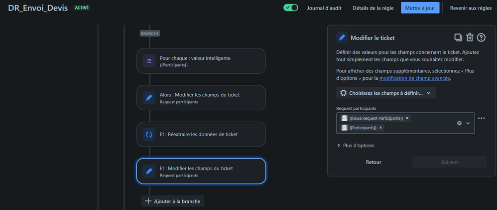

So with an AQL request I selected a list of users in asset and I stored it in a variable called {{Participants}}.
The list is OK and the variable works fine.
I used the Edit issue feature to SET Request Participants field with {{Participants}} then I re-fetched the data and again edit issue to SET Request Participants field with {{issue.Request Particpants}} and {{Participants}}. I read somewhere thant it was the way to have multiple users in Request Participants field.

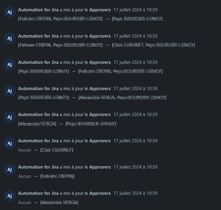

My problem is that it doesn't work fine. Sometime I have just one user, sometime two or three. My list for the test contains four users (named A, C, F, P, in the screenshot).
And when I look at the activity on the ticket I see that the user(s) in the Request Participants field have been change multiple times.

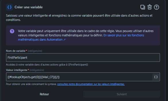

I found a solution about your issue :
Get object with the action block "Search objects", with this action block, you will get the objects in an array.
Then, you need to create the number of variables required for get individually each Requests Participants like :
{{FirstParticipant}} with the smart value using lookupObjects.get :
{{#lookupObjects.get(0)}}{{your_argument}}{{/}}
With the get(0), you will take the first object of the array, with the get(1), you will take the second object of the array, etc...
After that, you can add your request participants with your variables
Mario GELES
August 12, 2024
It works ! Thank you so much !
