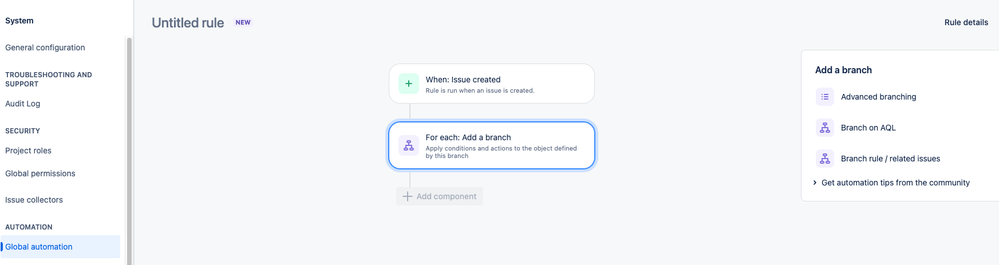

I just found it, they have moved it so you have to be under Global automation in order to get access to branch on AQL:
Like • arti_b_patil likes this
Arnold Rolle
July 15, 2024
You are a life saver sir! Thank you so much!
