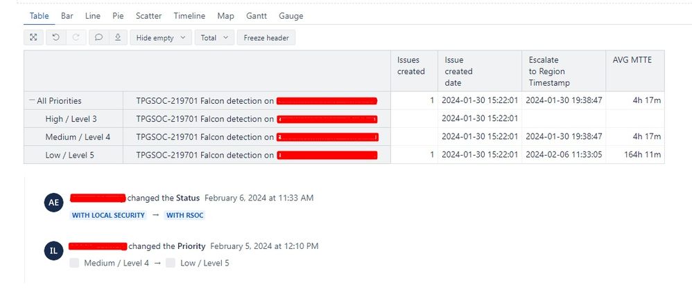

The problem i am dealing with is that there is some kind of reset to the Escalate to Region Timestamp measure when we change the ticket priority.
In the example below, the ticket was high priority when it was created and immediately changed to Medium. Then we transitioned the ticket to status With RSOC and we get AVG MTTE 4h17m.
After that the priority was changed to Low and then it was transitioned to status With RSOC again and the problem appears. We have another entry for AVG MTTE because as it looks like there is a new Escalate to Region Timestamp which is the same time with the time the ticket was transitioned to status With RSOC after the priority change.
So at my final report of AVG MTTE for all issues filtered by priority, the ticket above is calculated twice and we don't want that. We want to calculate only the actual first time the ticket was transitioned to status With RSOC when it had Medium priority.
Is there a way we can achieve that?

Hello @Ioannis Kouris ,
The "Transition to first timestamp" measure takes into account the full "historic context" - including the Priority.
If you want to only retrieve the first timestamp regardless of the issue priority or other dimension, you need to reset the priority (and other dimension).
The expression for the "first escalation timestamp" might be as follows.
([Measures].[Transition to first timestamp],
 [Transition Status].[With RSOC],
--reset the time dimension
 [Time].CurrentHierarchy.DefaultMember,
--reset the priority
 [Priority].DefaultMember)
Then, you might rewrite the MTTE expression so that it drops the issues of the second or further escalations.

Ioannis Kouris
May 29, 2026
Even if a bit late, thank you Oscars for your support
It worked but i had a bit of a load time issue so i created a new custom field in import options for priority
