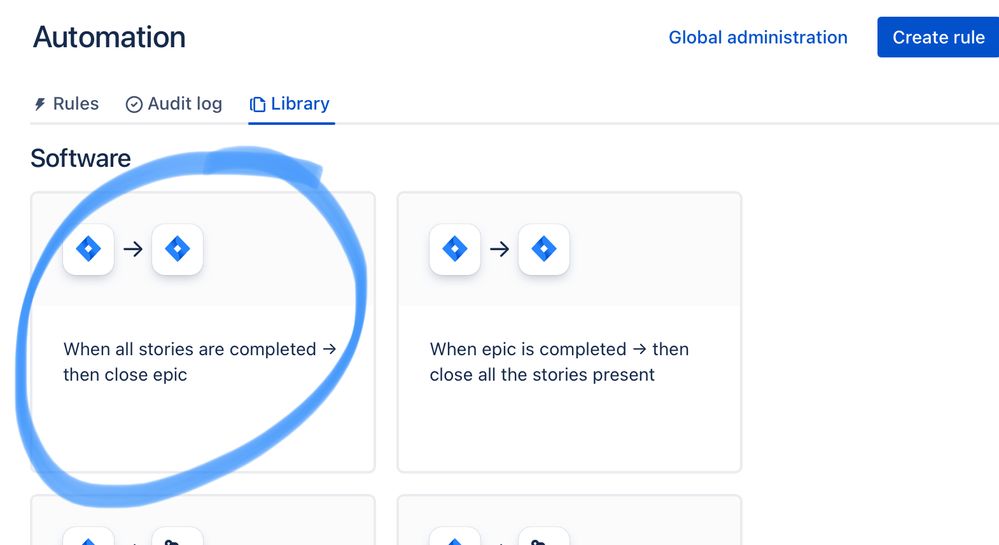

you could certainly add a custom date field and use Automation to set the Epic Status to DONE and the custom date field when all underlying issues are resolved. there is an automation rule in the library for closing the Epic when all issues are done. You could use this and add the action to set the date field.
Shipra Nirola
February 18, 2021
Thanks @Jack Brickey , I see these rules under my library . Would that one with parent and sub-task work . We don't have subtasks under epics. This is what we have atm:

Here is how rules look like:
Jack Brickey
February 18, 2021
Based on your original post I would suggest the one I indicated in my image.  Ultimately it depends on your process. For example if your team works on sub-tasks if they exist and not the parent then you could auto close the parent story when all sub-tasks are done using Automation and similarly close the Epic once all associated children stories are done.

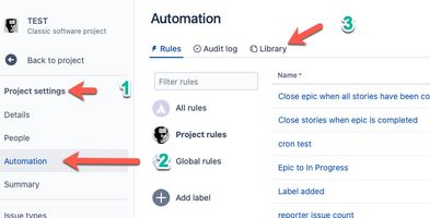

Sorry, My image wasn't uploaded before. I don't have the same option that you shared in my JIRA. Is there anything missing or Am in looking at the wrong location @Jack Brickey
Jack Brickey
February 18, 2021
unsure. you will find the library as follows...
  1. click on Project settings in your project
  2. click on Automation
  3. click on Library
