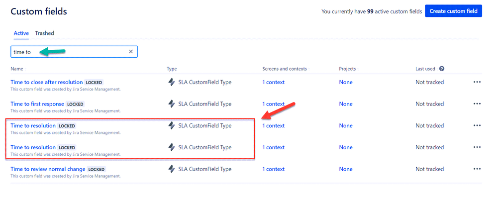

I just discovered that my Jira Cloud site has two fields labeled "Time to resolution."  Jira Service Management created both.  No other SLA fields appear to be duplicated.
Please take a look at the screenshot below.
My questions are:
  1. Is this expected?
  2. If not, can this be fixed? I can't remove or relabel either of the fields, as the system locks them.
Thank you for the help!
Screenshot:

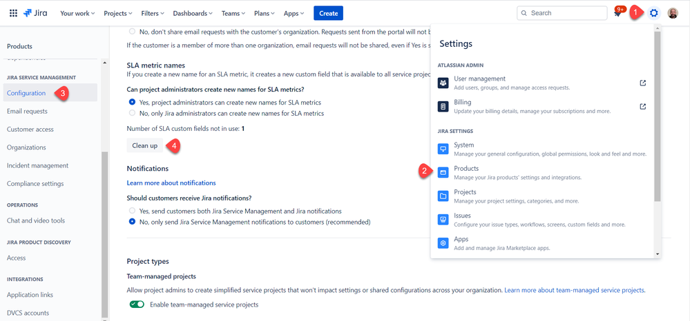

Follow-up: Atlassian Support provided instructions for fixing the issue.  I'll share the instructions here in case they're helpful to someone else in the future:
From Atlassian Support:
I found a related public knowledge base article that may help answer your questions: Duplicate SLAs in Jira Site Causing Automation Error.
In summary, the duplicate fields occur when you add the Jira Service Management product to your Jira instance. The ITSM Sample Space Service Project is created by default, which also has a "Time to Resolution" field. This results in two "Time to Resolution" fields being created simultaneously.
You can resolve this issue by either deleting the SLA manually from the Sample Service Project or, if the duplicate SLA is not in use (which is probably your case), you can delete it from Settings > Products > Jira Service Management - Configuration.
Please refer to the KB article for a more detailed explanation, screenshots, and steps to resolve this issue.
So, the root cause was I had an unused SLA field lingering from the since-deleted ITSM Sample project.  Because the project was deleted, I used the second resolution provided by Support:
Settings --> Products --> Jira Service Management Configuration --> Clean-up
Thank you to @Trudy P Claspill and @Andy Heinzer for helping this along!

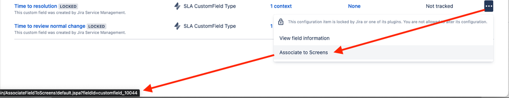

If you click on the Actions/... button for each field and hover over the X option, the field ID should appear in the URL at the bottom of your browser. What are the IDs for these two fields?
Aaron Morris
September 5, 2023
Hi, @Trudy P Claspill -- Thank you for the help!  The two field IDs are 10076 and 10080.
