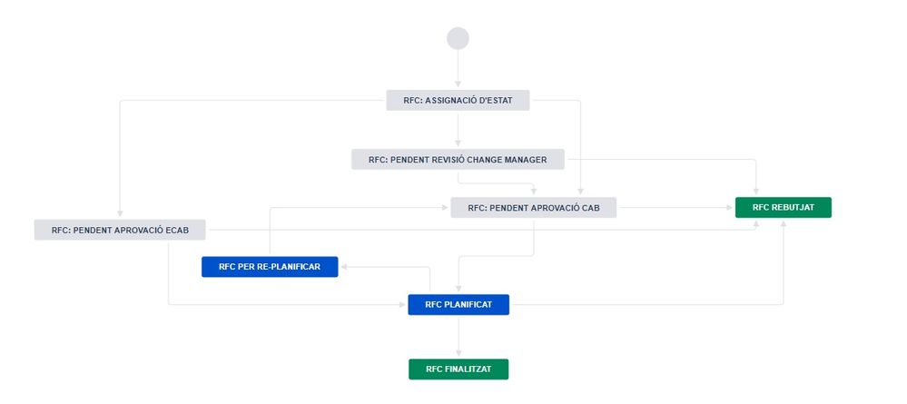

Given a Service Desk issue, created via SD portal, I want to transition the given issue to different statuses depending on the value of a field.
For that I've designed an easy workflow, as you can see.
workflow.jpgI wanted the first state to be like "filtering state", that depending of a given custom field, via automations,it moves the issue to either the "left path", "middle path" or "right path".

With no success (the issue stands in the first state - "RFC: Assignació d'Estat" in the picture-, without transitioning to one of those three "paths").

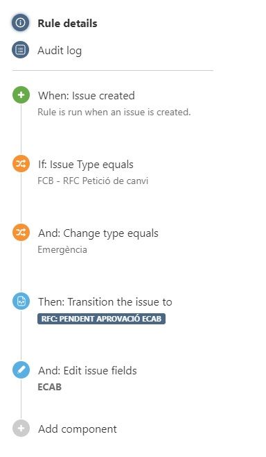

Here you have a sample of "take the left path" automation.
I basically do:
When issue created
If the issue is the issuetype I want and the value of the custom field is Emergency
Then transition to Emergency Approval ("left path") and do other things unrelated.
Note that I tried once issue is created, so I guess that means before arriving at the first and only state (the filter state that then splits into three paths).

Tracking the audit log I saw that is executing well.
The thing is that once you create a request, you are presented with the Jira SD form with the status on the first state, but if you refresh the page (or being an agent and administrator in my case, by looking at the queues, the status is transitioned to the correct path).
So it was my fault to not look at the queues!
