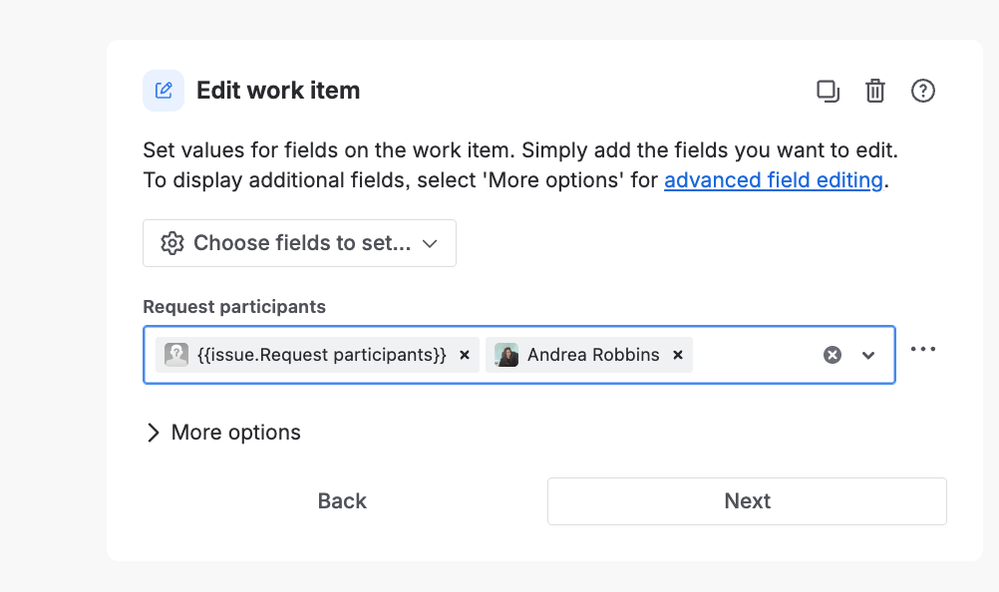

Two ways:

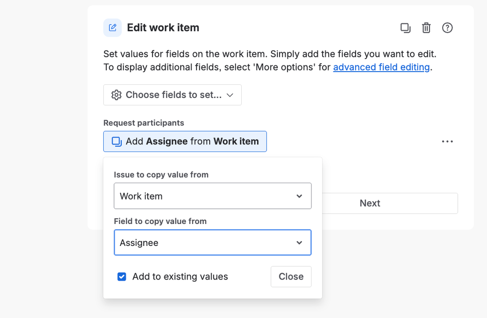

1. If copying from a field, ensure this checkbox is selected:

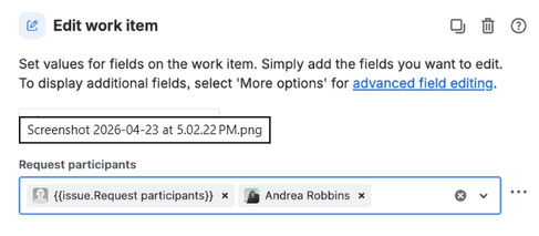

2. If setting the field, use the smart value of the request participants field plus a smart value for the new request participants you want to add: Screenshot 2026-04-23 at 5.02.22 PM.png
This is documented here:
https://support.atlassian.com/jira/kb/add-update-remove-request-participants-using-automation-in-jsm-cloud/
Hope this helps!

Dear @Andrea Robbins in my first test this works.
I will follow the log file to check from now on.
I have used this approach:
Thank you very much!

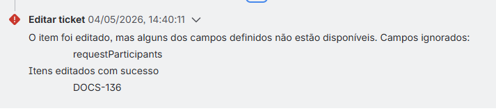

there is an issue regarding to this solution. Take a look at:
This mean:
The item was edited, but some of the specified fields are not available. Ignored fields: requestParticipants
The requestParticipants is on the Edit and Create screen.
And so I do not have the expected result.
Do you know what could be wrong?
Thank you.
Jader
Andrea Robbins
May 14, 2026
I am assuming it is on the layout as well? I would reach out to Atlassian support. It's possible there was an incident at the time it ran maybe.
