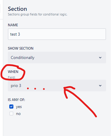

Hello team,
I am having troubles with Jira forms, I am creating a set of yes/no questions that will, depends off your answer give you the correct answer. I do not see the option that i can use multiple conditions for the same section.

Jovana Pranic
January 13, 2023
Hello Joseph,
Thank you for the answer.
this is nesting the conditions; I need to show the same Jira filed multiple times, based on answers that will be provided in the jira forms.

agreed with Jovana - I am wondering the same. Can we link the same Jira field to multiple Proforma fields if the Proforma fields are in a conditional section?

Unfortunately, once the field (Jira) is mapped - You cannot map it again against other proforma elements (fields) again.  It is a known limitation with the tool.
I would recommend that you raise this issue to Atlassian Support team as a possible enhancement (https://support.atlassian.com).
