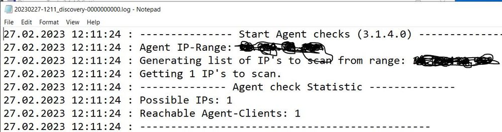

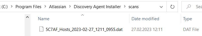

thank you for your message. I was managed to install the discovery tool. But I was not successfully to fetch the data. For the test I just want to fetch the data from the jira server itself, but I could not find any data! The log file appears to be ok for me.
discovery-filecopy.JPGThe only file I see is .DAT that after I trigger Agents to scan.
The log file seems to be ok.
Did I miss anything here?
Thanks so much for you help :-)

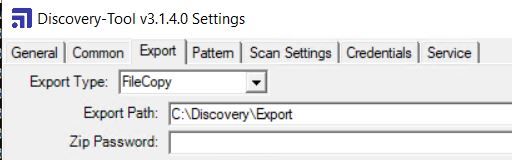

I see you are using Discovery agent to scan your servers. That is fine. Just for information, you can also scan Windows devices through the network without an agent.
According to your log file, Discovery server should have fetched that .dat file from your Windows server and you should have found it on Discovery/scans directory.
There is a button on "Service" tab at Discovery app that says "Trigger agents to scan". That triggers your agents servers (Jira server) to a local scan and the results must be transfered to Discovery server. Use it and check your Discovery logs to find some hint.
Note: Confirm if it's possible to Discovery server reach your Jira server through 51337 (default) port.
If you still can't fetch that file, give a try to a network scan, where Discovery server will try to connect according to your configured servers on "Scan Settings" tab.
This documentation might help you:
https://confluence.atlassian.com/insightapps/set-up-insight-discovery-1085180655.html
https://confluence.atlassian.com/insightapps/scan-settings-1085180664.html
