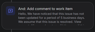

A comment is then added to the ticket to inform the customer.

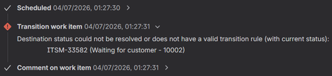

This is a very simple rule, yet 95% of the time it errors on the transition step. However, the ticket is transitioned to "Resolved" and the comment is applied.
I have reviewed the ticket history & comments to see how things played out, but it's always the same. The rule errors, but if it wasn't for the alert email that I get, I wouldn't know that it errors cuz everything appears to happen that should happen.

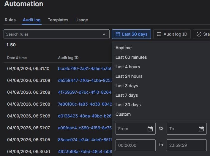

@Brian Jennings I have had this happen before as well. It was usually due to something else transitioning the status before the Automation rule gets to it.
Check the History tab to get the timestamp of the transition and then check your Automation Audit log using the Custom date filter.

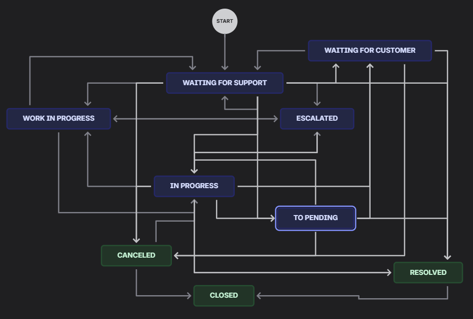

Here's the workflow diagram. This workflow does not contain any global transitions to "Resolved". Sidenote: This workflow was created by the original Jira vendor with whom we partnered. It looks messy, yes, and I'm not sure it is best-practice or not. I'm not sure why they added a "Work in Progress" status when you already have "In Progress".
With the comment that I originally made, I just meant that there are valid transitions from previous statuses to "Resolved", which you can see in the workflow above.
This one workflow is used with a few Request types (including Service Requests & Incidents) in our main service space and is single-scope, just used in this space.

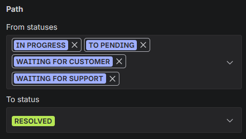

Is there more than one transition from the starting status to Resolved in any of the cases where the error has occurred? I am not able to discern that from the graphic.
Brian Jennings
April 10, 2026
Hey Trudy,
