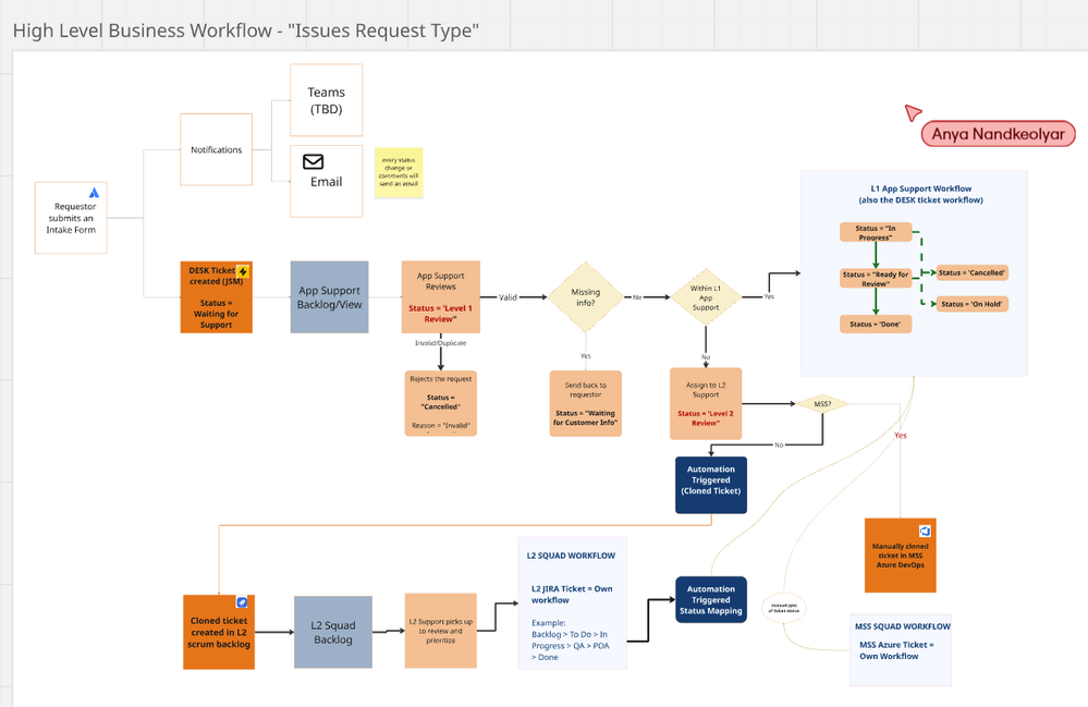

Hi,

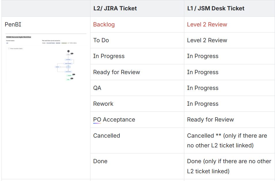

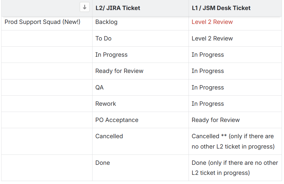

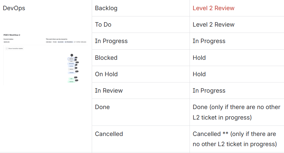

I am trying to build an automation where I want the cloned tickets (which will be going into separate project teams that will be working on their tasks) to communicate with the original desk ticket. This is how I want the status to reflect (attaching the whole workflow, and level 1 vs level 2 status reflections for each project team, which is prod squad, penbi team, and devops team):
Also, when there are multiple clone tickets within the desk ticket, I want the desk ticket to resolve/close when all the sub-tickets or cloned tickets are resolved/closed.

Based on the mappings in your screenshots, I'd treat the desk ticket as a rollup. If every linked clone is either Done or Canceled, the desk ticket can be moved to Done. If any active clone is blocked or On Hold, the desk ticket should probably move to hold. If any clone is actively being worked, reviewed, tested, or reworked, keep the desk ticket in In Progress. I'd only move it to Ready for Review once all remaining active clones have reached the acceptance stage. Until then, Backlog and To Do clones can keep it in Level 2 Review.
