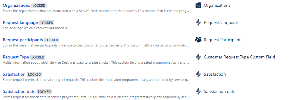

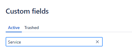

To supplement what @Brant Schroeder suggested, if you access the system "Settings" >> Issues >> Custom fields, you will see all the JSM out of the box fields are flagged with "LOCKED" symbol.  You can search for the key word "Service", you should get all the JSM default fields -
You should see the fields with the flag.  Example - a few fields for your reference

Great, thank you. I think that was what I was looking for: confirmation that the JSM out-of-the-box ones are marked as LOCKED so I can safely delete other custom fields.
