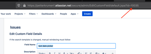

In order to confirm you are pulling the correct date field and not another custom or system hidden field with the same name, I suggest you to use the custom field ID instead of the name to reference it in the smart value of the automation. These would be the steps:
  1. In your Jira site, Go to settings (Cog icon at the top-right corner) > Issues > Custom fields
  2. Find the Date picker custom field you created > Click on ... > Edit Details
  3. In the page opened, copy the custom field ID at the final of the browser URL:
  4. Use the following smart value to reference the date picker field in your Automation rule where "xxxxx" is your custom field ID number:
    {{issue.customfield_xxxxx}}

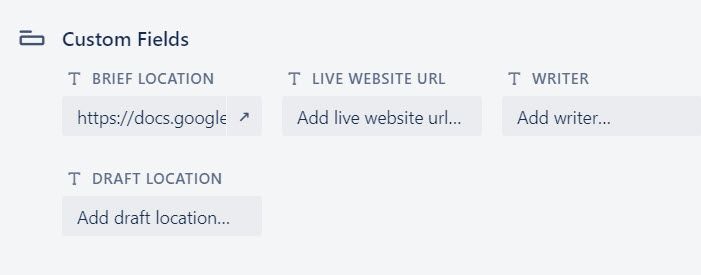

I'm trying to take the link to a document from the custom field
and then create a rule based on the person we want the email sent to and create the message to include the document link.
