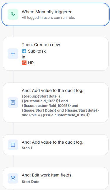

Rich Douglass August 6, 2025
Thank you all for your responses. I hope I get all the info you need to help me. I am a newbie with this, so please bear with me.

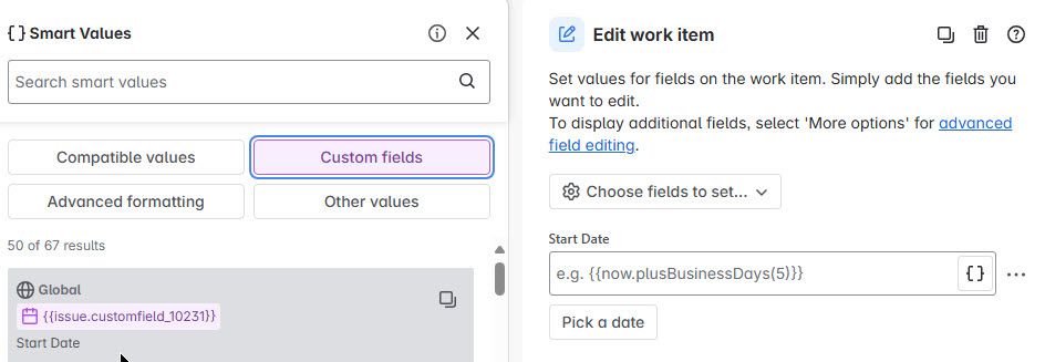

I want to update the Due Date field when a work item is created based upon the Start Date that is entered by the user. Both fields are of Date type. One thing I am seeing is that when I output the field values to the log, I get nothing for the date, yet the Start Date shows in the work item view.
The smart value for the field is the same in the JSON as when I create the step to update it:

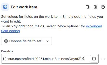

The rule is now trimmed to the following:
The calculation should subtract 3 BD from the Start Date and put it in the Due Date:

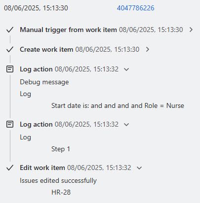

The log says everything is fine:Log.jpg
Hopefully this is all you need. If you need additional details, please let me know. I can see the power of what the automation can do for me if I can get this example to work.
Thanks again.
Rich.
