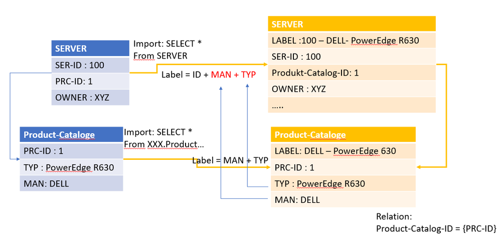

Many thanks for the friendly welcome. I have already read the link and unfortunately it didn't help me. Pictures often say more than words, so I'll try again with a picture. We have also used CSV for imports in the past, but I have to say that it was not always stable, so we switched to the DB interface. A link to the product catalogue is also no problem, but I would like to use some attributes from the other table during import, e.g. to fill the server label with the manufacturer name and also the types, so that the name is more descriptive. I hope that someone has an idea how I can handle this case. Thank you for your time and effort.

I'm still not a hundred percent sure if I got your problem right, but shouldn't you be able to update the import statement with a JOIN, to get data from both tables?
After that you should be able to use aql on the attribute mapping screen, to filter out the specific object for the type attribute based on the value from the join.
Actually I haven't done that before but I guess that should work.
