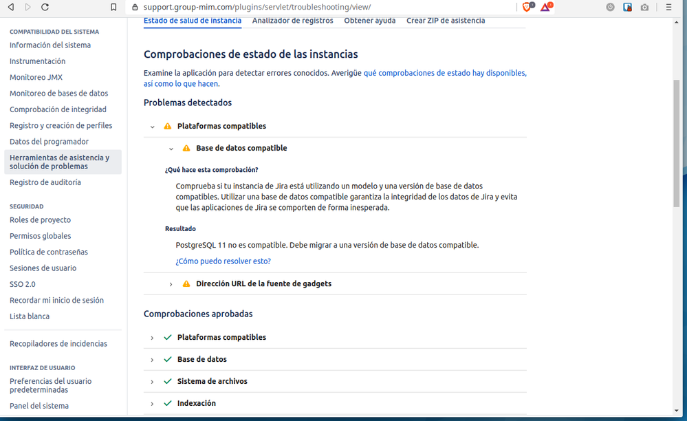

The error is database not compatible. I use postgresql 11
Hi @Eduard Lecha Puig ,
this might be because you're using Jira 8.5 for example : on this version, it's compatible with PostreSQL 10 as you can see in the documentation here https://confluence.atlassian.com/adminjiraserver085/supported-platforms-981154553.html
