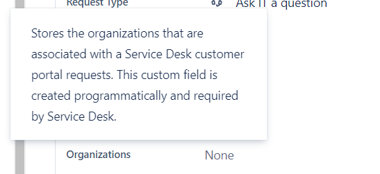

What I have discovered is that against the ticket, there is an organisation field with the company selected in there. If I remove that company field the ticket disappears from the other users view.
Firstly this doesn't make sense that this field controls the sharing permission. Both users are actually in the same company so it makes sense that the company field is populated to inform the agent which company that user is from regardless to the 'sharing' option.
So I'm going to guess there is a setting somewhere that says 'Users in the same organisation (based on that organisation field), can see each others tickets', and that needs to be disabled.
You should be able to set the organisation field against a user/ticket without tickets being shared between users in the same organisation.

@paulcreedy I agree with you that the ability to share with the organization being based solely on the Organizations field is poorly thought out.
That said, it sounds like you might have the default for that field set to share with the organization. Go to Settings --> Products --> Organization management. Make sure the setting Should new requests automatically be shared with a customer's organization? is set to No, don't share email requests with the customer's organization. Requests sent from the portal will not be shared unless the customer selects otherwise.

When the organisation field on the ticket is subsequently populated, the ticket is then shared with other staff without warning.
This is a field that has an implied purpose. To specify which organisation the user of the ticket is a member of. There is no other way on the ticket to see the organisation other than to populate that field.
To then also use that same field to share all the potential confidential information with every other member of staff without warning is absolutely WRONG.
This is a really really bad idea and one of the most stupid and hidden I've ever come across is a professional paid for product. What is essentially happening here is a 'feature' is being controlled by a completely unrelated field that has another more legitimate purpose. There should be a separate field for sharing, not lazily hijacking another field for it's purpose.
A user populating the organisation field is also unknowingly allowing all other users in an organisation access to potentially confidential information. This is a serious flaw in the product and would very likely be considered a data breach under UK and EU law.
There is absolutely nothing to indicate that the ticket is about to be shared with the entire organisation.
