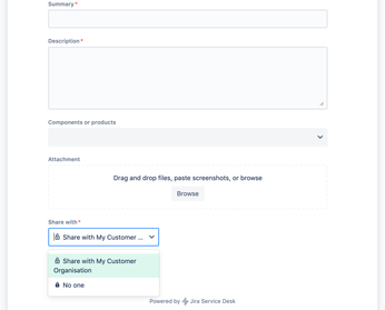

When someone is added to an organisation and creates a ticket, he should see, at the bottom of the ticket, a "Share with" list with the organisation selected by default.

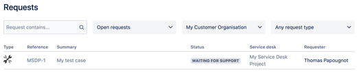

Once created, all users added in this organisation, should be able to see this ticket, using the menu on the top right of the portal.

This could be it, but that field is not showing by default on any issue creation form. So I guess I need to add it.

Are you testing with a user added to the organisation ? If you add yourself and create a ticket, you should see this sharing list.
