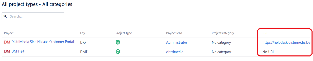

I've then changed the secont project > edit + filled out field URL with the same URL as the first project, being the URL of the portal.
After that I could log in with that user on the portal, but when creating new issues, they appear in the wrong project ...

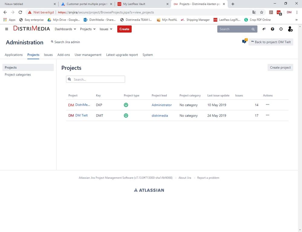

Projects:

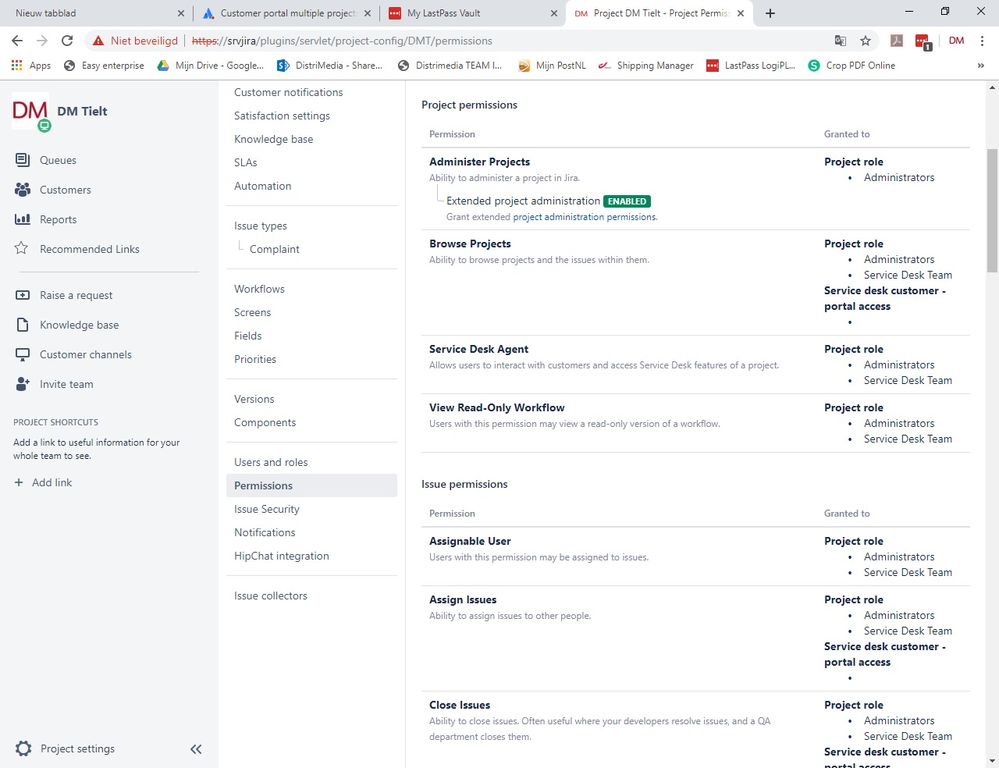

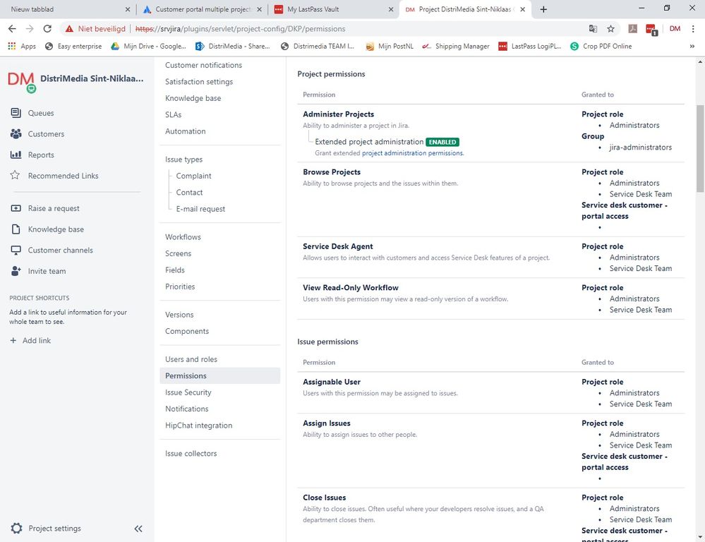

projects.jpg1. Permission schemes both projects:

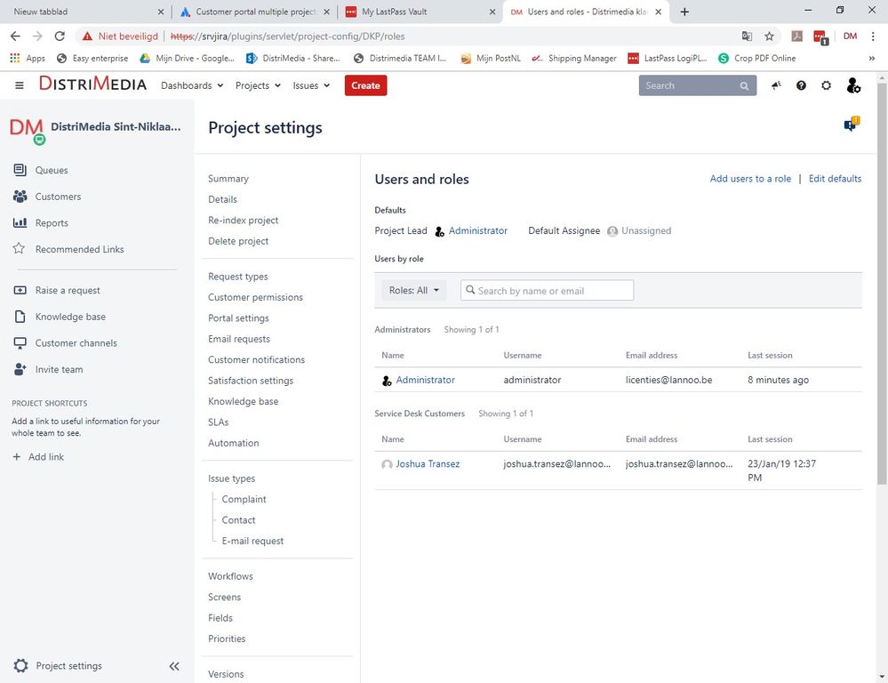

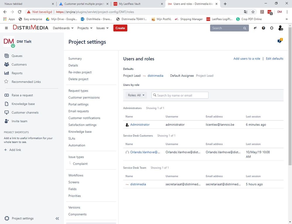

2. Roles both projects

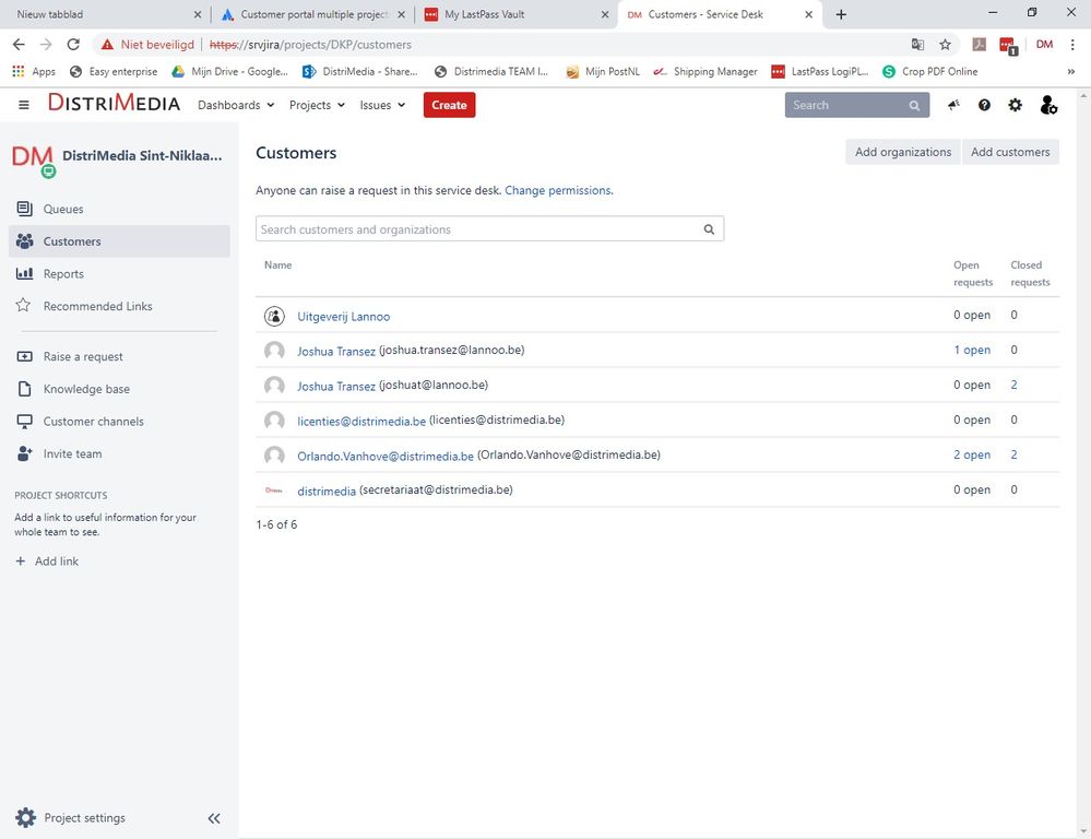

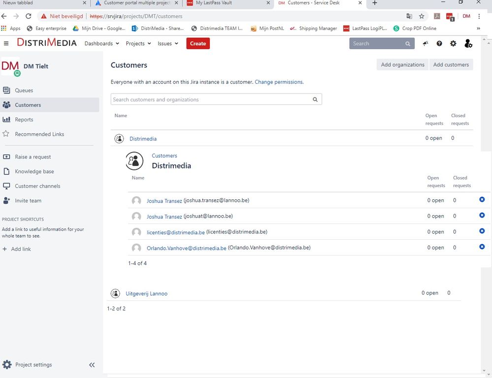

3. list of customers both projects:
So I noticed my e-mail adress on which i did the thest (orlando.vanhove@distrimedia.be) is on both projects...but the complaint was only shown at project "St-Niklaas"

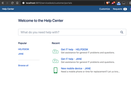

With Service Desk there is a separate customer portal where these unlicensed users in the customer role can access the service desk to create and view their requests.  This URL tends to look like this  [JIRAURL]/servicedesk/customer/portals
You can see what mine looks like with 2 service desk projects
The project names here are JANE and HELPDESK in my example above.
When you reach this page, you will see both portals if your account has permissions to create issues in both.  With Service Desk you can restrict on a per project basis who creates these users in a customer role (themselves or only agents), and you can restrict other customer permissions like who those customers can share requests with.
I can see from your screenshots that you have these two projects configured slightly differently. In the DKP project for that customers page it states "Anyone can raise a request in this service desk" - that means anyone can create their own account and create requests there.
But looking at the DMT customers it states "Everyone with an account on this Jira instance is a customer."  Slightly different, just stating these users need to have an account first.  This tends to be a factor when users are trying to send email to the mailbox service desk is configured to check.  These project settings can determine whether service desk should create accounts for each email address in that message or not as well as whether or not the process the message at all (say because public sign up is not enabled and the user doesn't have an account yet).
It might help to take a closer look at Managing Access to your Service Desk.  It helps to explain the project level settings in detail so that you can make sure that your users can access the project or projects that you want here.
