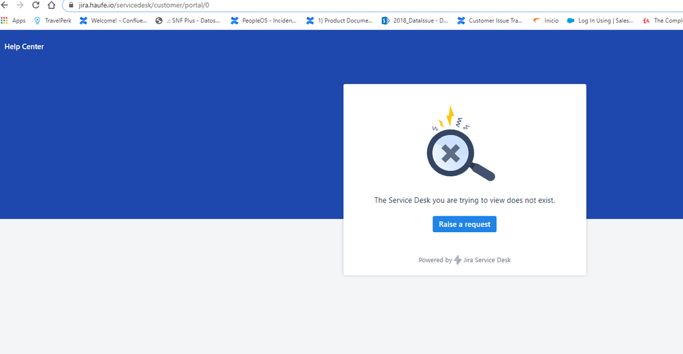

Hi All,
I'm trying to access the Customer Portal through the Raise a request icon in Jira SD and I get the following error on the Customer portal
I have the administrator role in Jira SD.
Many thanks,
Carlos

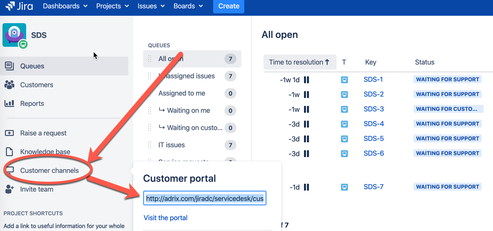

Hi @Carlos de Magalhaes
Can you confirm that the base URL is configured correctly? We have seen issues like this in the past if the base URL is not correct.
You can confirm the portal URL by going into the project settings > customer channel :
Adrian Stephen
January 31, 2020
I was able to reproduce the problem if the portal URL does not exist.
For example, if my portal URL is  http://hello.com/jira/servicedesk/customer/portal/1
and if I changed it to http://hello.com/jira/servicedesk/customer/portal/0
it will show the same screen as you are seeing because it does not exist.
Carlos de Magalhaes
January 31, 2020
what should I have there?
Susan Hauth _Jira Queen_
January 31, 2020
Looks correct.  How is the portal access?  Can you create issues from there?

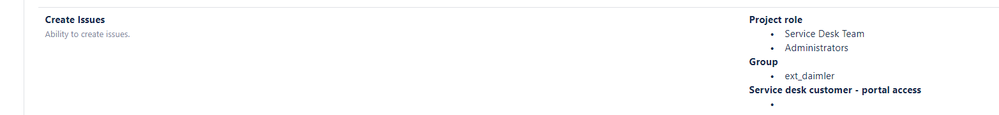

January 31, 2020
Yup,
And what is the create permission.  As that is what would stop you.
Susan
Carlos de Magalhaes
January 31, 2020
Hi Susan,
thanks for the reply
Yes, I am also a customer/user of the service desk.
Thanks

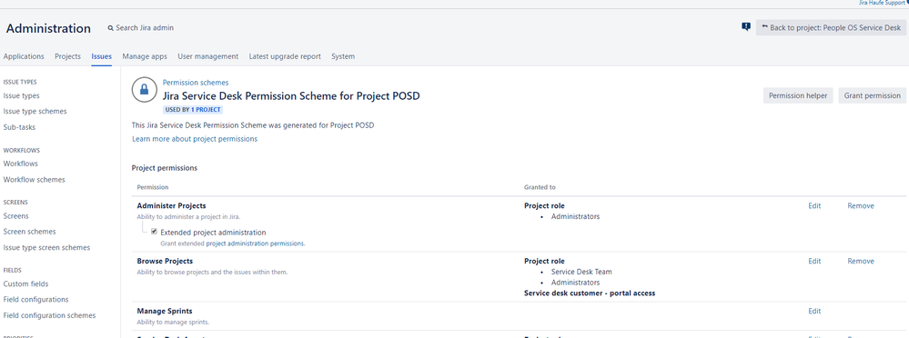

January 31, 2020
Hi,
Do you want to paste your permission scheme in here?
January 31, 2020
Hi,
Did you check the permissions to make sure you are a customer/user of the service desk.  Being an admin doesn't automatically grant that.
