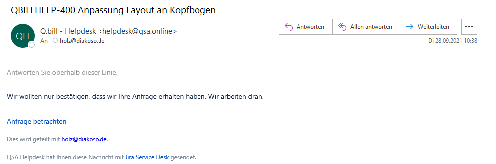

Hello, I have a problem with my customer notifications. Above the line at Reply above this line, the following is displayed for me:
"@context":"http://schema.org","type":"EmailMessage","description":"View request","potentialAction":{"@type":"ViewAction","target":"https://wdrh.atlassian.net/servicedesk/customer/portal/1","name":"View request"},"publisher":{"@type":"Organization","name":"Atlassian","url":"https://www.atlassian.com" }}
That looks like a misrepresentation. I don't know where to fix this problem.
Can you help me?
Many greetings
Ronald

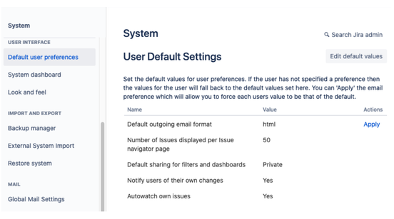

Please go to Cog icon > System > Default user preferences.
If the “Default outgoing email format” is set to Text, please click on “Edit default values” and change to HTML > Update > Apply.

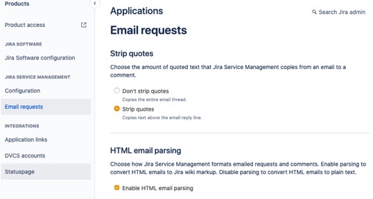

Also, please, go to Cog icon > Products > Email requests and confirm if the “Enable HTML email parsing” is checked. This setting is specific for customer notifications.

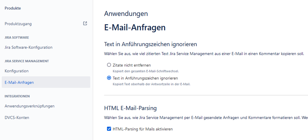

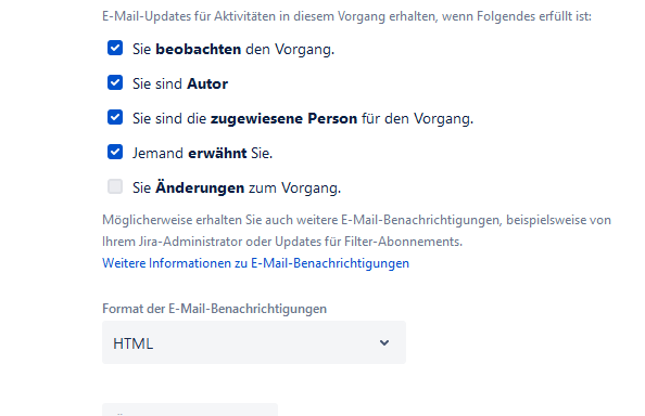

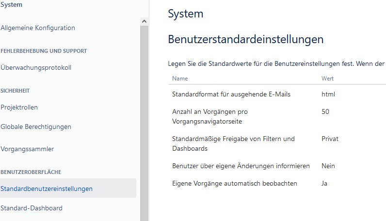

thank you so much for your information. I checked the settings but unfortunately everything was already set to HTML. I am sending 3 screenshots here.
jira 2 2021-09-29 174353.pngjira 3 2021-09-29 174353.pngjira 2021-09-29 174353.png
