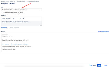

  1. Navigate to your Service desk project > Project settings > Customer notifications
  2. Click to edit the Request Created notification
  3. Check if the reporter of the issue is properly added to receive the notification:

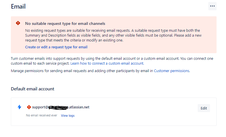

Madineni
March 14, 2021
Hi @Petter Gonçalves ,
I'm also facing the same issue, only in one projects, the customer not receiving this notification and I have checked all the 5 steps mentioned above, still the issue not resolved.
I'm guessing this is due to the following problememail request1.PNGCould you please provide your thoughts on this issue.
