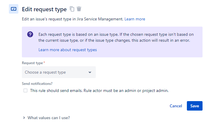

Hi @Simon Länglacher ,
It is probably because there is no Request Type set on the cloned ticket.
If you set that the issue will appear in the portal, for reporters and request participants.
You should use the *Edit request type*, to change the request type.
Simon Länglacher
September 11, 2023
Yes, you are absolutely correct
Thank you very much

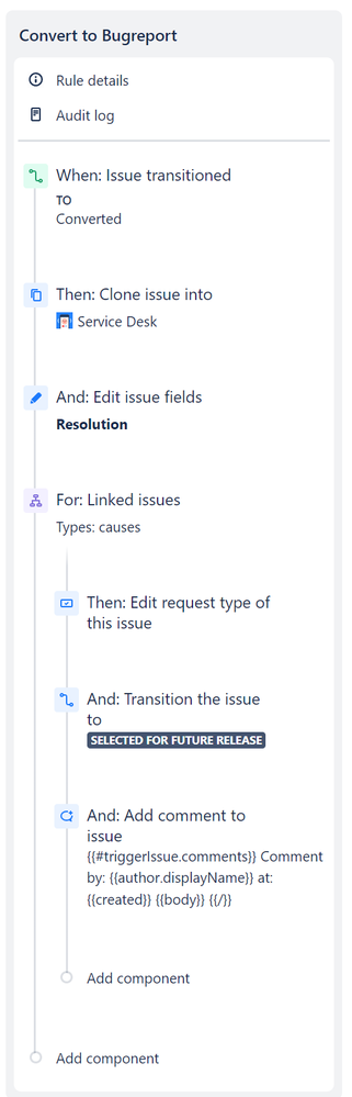

Simon Länglacher
September 11, 2023
This is the Automatisation I use to Convert Service tickets into Bugreports

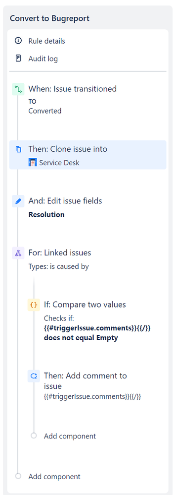

Simon Länglacher
September 12, 2023
For completion sake, this is my edited version of the Automatisation that works (including adding all comments from the original Issue)
