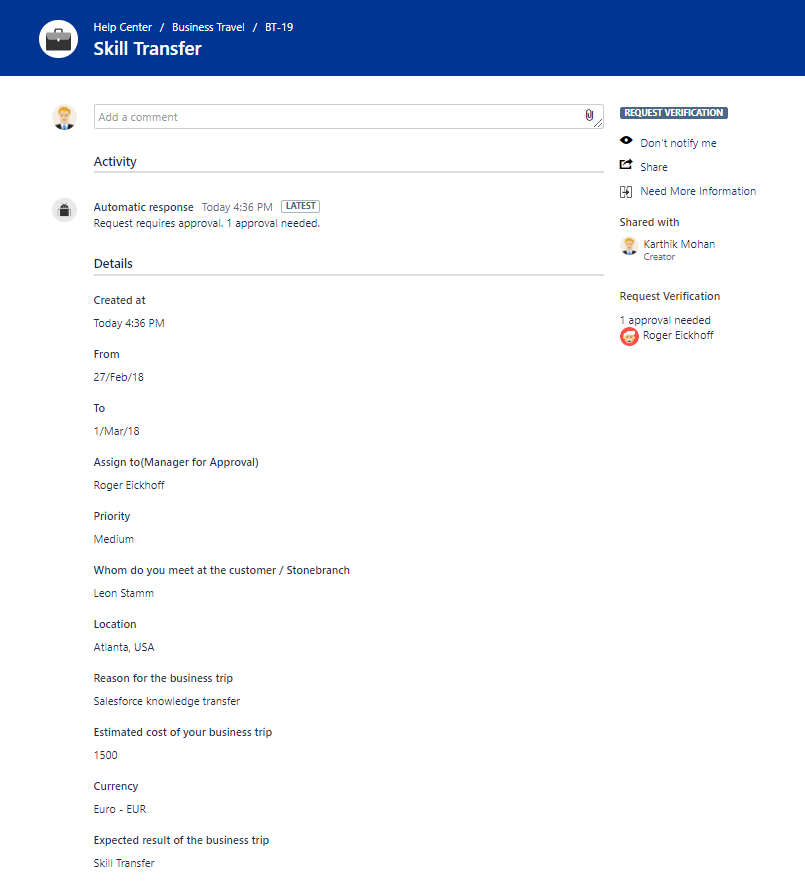

Karthik Mohan
February 26, 2018
When the user click on 'Need more information' button, the issue status should change to 'Need more information'.  Every user must be able to do this transition.
Karthik Mohan
February 26, 2018
when i click the transition button nothing is happening.

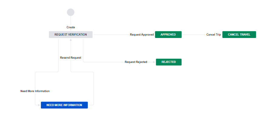

Can you share your actual workflow? I suspect that there is an error in the workflow but just a guess at this point. When you take a screenshot use the diagram and include the transition labels.
Karthik Mohan
February 26, 2018
Karthik Mohan
February 26, 2018
Thats the work flow
Jack Brickey
February 26, 2018
Thanks, so for the NMI transition to work then the current status needs to be "Request Verification". Can you confirm that is the case? Assuming the current status is "RV" then have a look at your post functions. Can you share those?

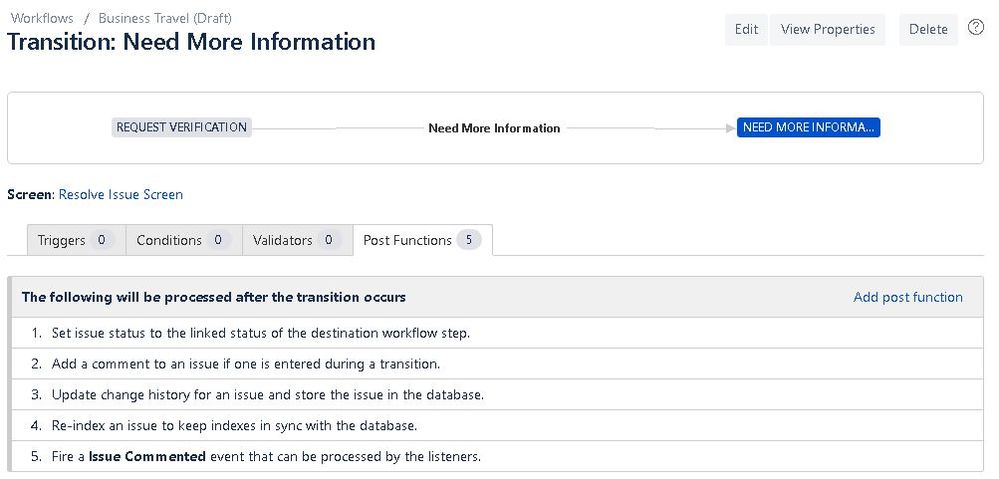

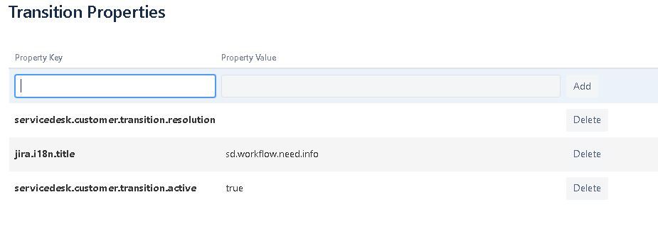

Yeah your assumption is correct .RV is the current status. I have attached post function and also the transition properties for refereCapture.JPGCapture1.JPGnce.
Jack Brickey
February 26, 2018
i am not seeing anything immediately that looks out of wack. So we are going to need to dig deeper.
