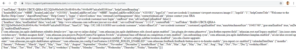

We use the Server version of the Jira Service Desk, and now we are trying to create a public webpage for the Customer Portal. It is installed to our private server, which is not accessible for customers, so we would like to redirect it to a public page. With IIS we could not do that, so we decided to use a separate physical Linux server for this (using Tomcat).

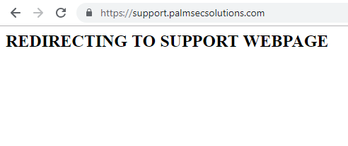

Our system admin tried everything, but now we get the following error message when we try to reach that public webpage:
Could you please help what could be the problem? I tried to find any known issues about it, but I am not the responsible for this task in our company, I just try to help to our system administrator.

This is your Tomcat server throwing back data instead of sending the page data.  It's obviously getting something from Jira, but not processing it correctly.  This isn't a Jira problem really, its in whatever you are doing in the "redirect".
Ideally, you should probably do a complete redirect - the server at support.palmsecsolutions.com shouldn't serve up much more than a tiny bit of Javascript that takes the user off to the Jira portal.

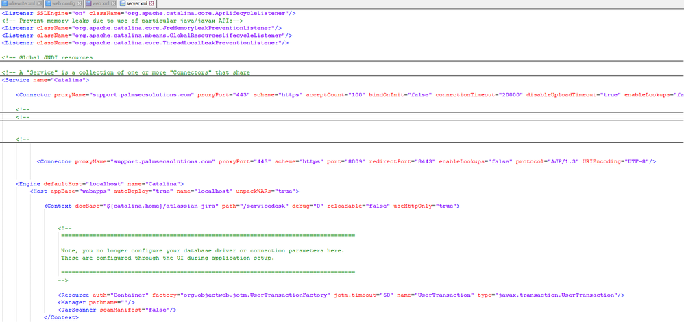

In the meantime I tried to set the Jira connector (according to
https://confluence.atlassian.com/adminjiraserver/configuring-the-base-url-938847830.html). I modified the BaseURL in the System settings, and I also modified the \conf\server.xml file. However, it wasn't clear for me if I need to modify the \Confluence\conf\server.xml OR \JIRA\conf\server.xml file. I tried first with the \JIRA file. I stopped the "Atlassian JIRA" service, and modifeied the server.xml file as follows:
<Context docBase="../servicedesk" path="/servicedesk" reloadable="false" useHttpOnly="true">
However, the JIRA service cannot be started, it failed with an error. With the original server.xml file it started properly - so I copied back the original one.

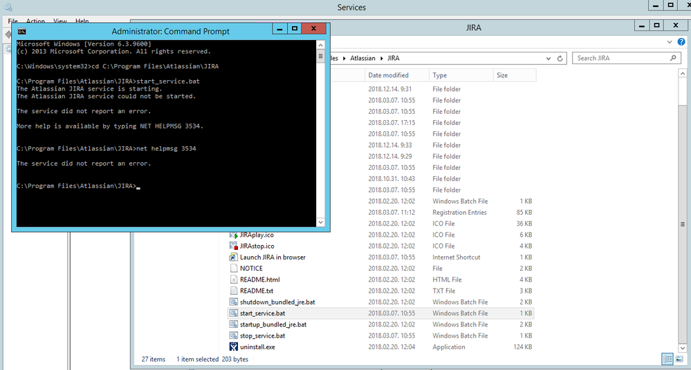

So I tried the same again (with the \JIRA\conf\servr.xml file). When I try to start back the JIRA service I get this error.
I doublechecked: only the <context> line has been modified in the server.xml file.

I made some tests with the server.xml file, and learned the followings:
- if I set the original docBase value back to the original one (<Context docBase="${catalina.home}/atlassian-jira") the JIRA service can be started. So only the "path" value was modified to path="/servicedesk" .
With this settings I could reach the https:\\support.palmsecsolutions.com public website; however it was not the Customer Portal, but the Dashboard.
Here Jira throws some error messages:
The Tomcat server.xml has an incorrect configuration:
scheme should be 'https'
proxyName should be 'support.palmsecsolutions.com'
proxyPort should be '443'
So I added this info to the server.xml file. Now there is no errors, BUT:
