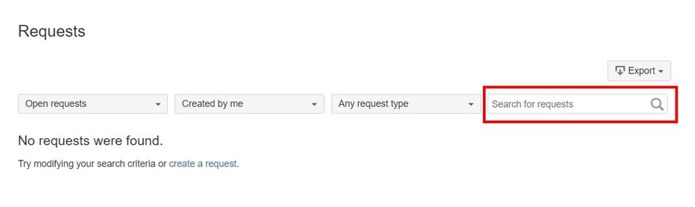

In my knowledge, 'Search' feature in my request screen is only available  to search for 'Reference field(ticket number)' and 'Summary' field.
1. Is it right?
2. What is search rule? It seems like 'equal' not 'like' algorythm. but it is not specified. I could not find document related to 'Search' feature in My request. it support advanced search? or any other way?

Yes, you are correct.  This search field does not have much in the way of documentation about it.  There is actually very little that you can configure here.
Inside the customer portal, you can search for your own requests, or those shared with you.  You are correct that this search is limited to the issuekey (reference) and the Summary.  And again, you are correct that this search is using a full word searching, it is not using a like parameter to obtain partial word searches.  Nor is it using word-stemming that Jira Core searching in the issue navigator has.
There is an existing feature request to improve the search in the customer portal over in https://jira.atlassian.com/browse/JSDSERVER-1544 I would recommend voting and watching that issue for updates.
