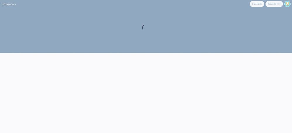

We had a JIRA Service Management 8.14 and I recently updated to 8.22. Once the update completed I was able to log in and view all requests submitted and form and SA standpoint is was fine, but it seems the Customer Portal page broke to some degree. The page resolved and loads with no errors but nothing displays (See photo #1). I don't know what is causing it and searching online for hours yielded no results about my issue.

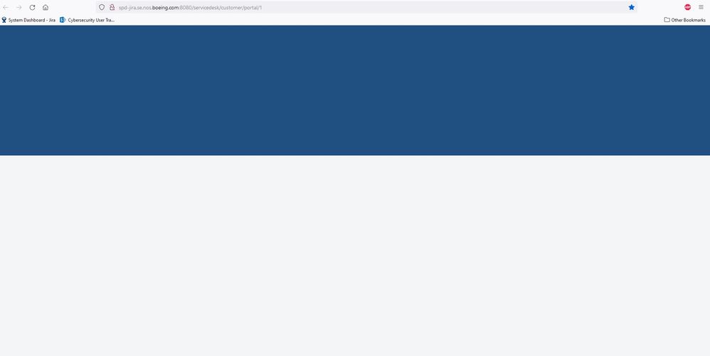

If I mess the the URL a bit I can get to the help center which displays the three projects we run but when clicking on any link from there I get a spinning wheel (See photo #2). I'm out of ideas and would appreciate any and all help.

And if you mean page load as in the browser console there are a heap of errors (16 in total). Referencing multiple different files getting 404 and 403 errors from jsm files. If you are referring to something else, could you please elaborate on "page load"

I think the issue lies within the:
"uncaught exception: Attribute 'portalId' does not exist"
When looking at the page source one of the three portalID's (We have 3 projects) is -1

So I was helped by a gentleman from the Atlassian service team name Kevin. He asked me to upload the logs, some HAR files and a browser console log. He was able to determine that the service desk front end plugin never updated and was still running the 8.14.1 version rather than the 8.22.1 version. He instructed me to down the obr, extract the plugin and replace it. I downloaded and extracted the file. Shut down the service, replaced the file and deleted the old one. Started the service pack up and it worked like a charm.
