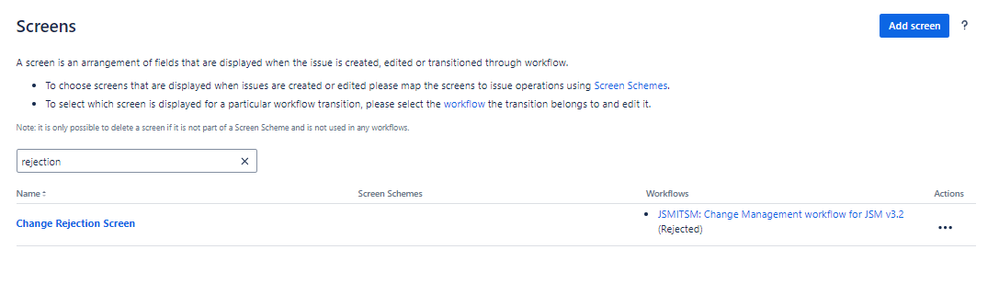

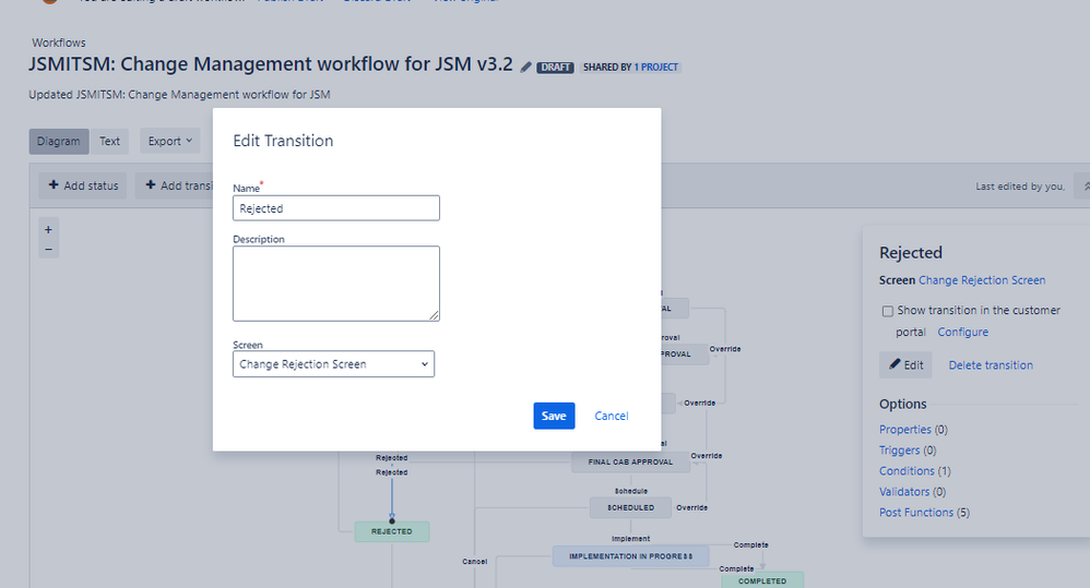

@Joseph Chung Yin ,
Attached is the screenshot of the rejection screen, which includes one field.
Also attached is the screenshot which shows it is attached to the proper workflow and added in the status transition in workflow.

Vijay Dadi
May 13, 2024
@Bastien Delourmel _FMX_
Here are the screenshots.
Screen is associated with proper workflow and workflow is associated with proper issue type which is change.
