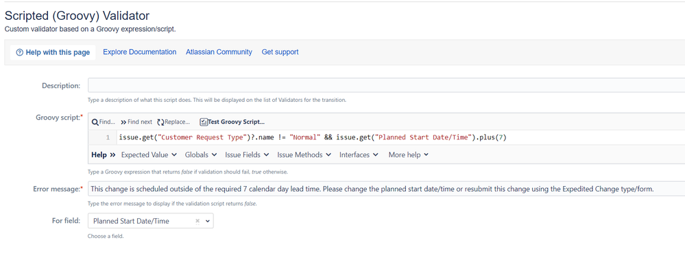

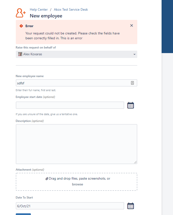

We have four change request types. For one of the request type (Normal), we need a validation for custom date field (Planned Start Date) where there should be an error message if user tries to enter a date that is less than 7 calendar days. I tried using Scripted Groovy Validator, but not receiving the error message. Please see attached screenshot.
Can anyone help with this?
I would like the code to be executed and the error to be displayed when somebody is entering a value for Planned Start Date field in the Create screen. (Only for the Normal request type)

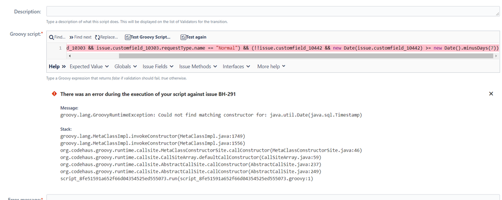

Thank you very much for providing the code .
I inserted the text provided. But still no luck.
Below is the screenshot of the error.
Please let me know how to fix the issue.

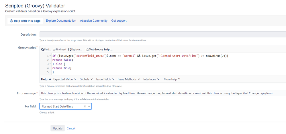

Hi @Pavan Chiti
It seems that I've missed an if statement. Try the following please:
if (issue.get("customfield_10303")?.name == "IT help" && issue.get("Planned Start Date/Time") >= now.minus(7)){

Thank you @Alex Koxaras.
Code executed with no errors, but not receiving the expected error message when a date is entered in Planned Start Date field.
My use case is when a date within 7 days is entered in Planned Start Date field from the current date. For example if I am creating the Change today and if I am entering any date from today to 10/13, an error should be displayed and if any date after 10/13 is entered no error should be displayed.
Attached is the screenshot for the text I entered.

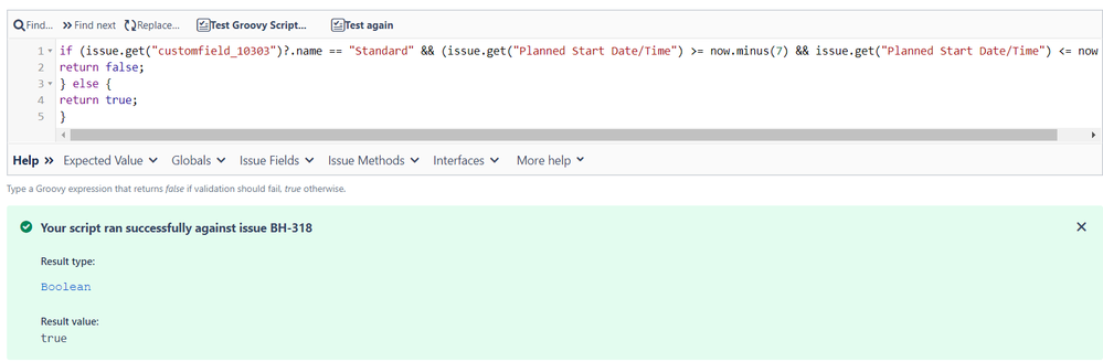

Maybe something like this?
if (issue.get("customfield_10303")?.name == "IT help" && (issue.get("Planned Start Date/Time") >= now.minus(7) && issue.get("Planned Start Date/Time") <= now )){
return false;
} else {
return true;
}I mean you can find the answer yourself about this Pavan:
So this is the interval which you want an error message to appear. All other values will be considered as correct.

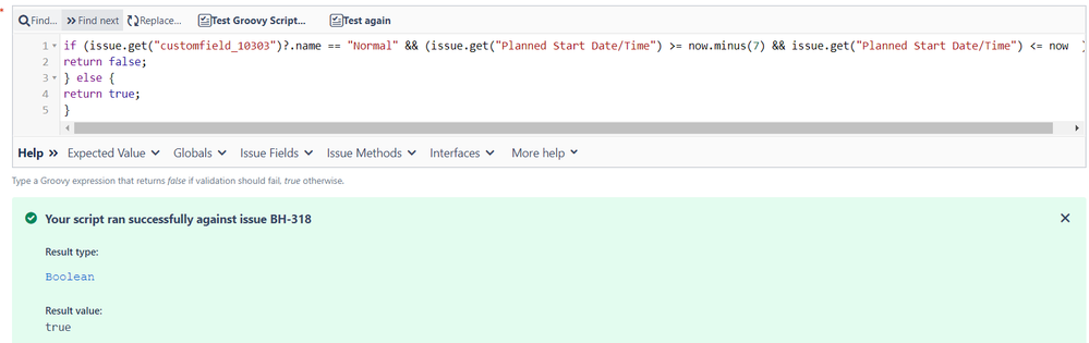

Code executed perfectly but not receiving the expected error message for any date and Request type is entered in Planned Start Date field.
Code is returning true for both request types Normal and Standard even when the Change for created for only Normal Change.

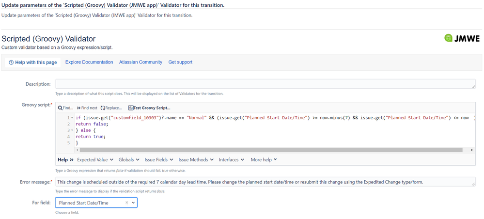

Did you add this script as a validator on the create transition?
Yes, below is the screenshot that shows the code was added into the validator with the error message that needs to be displayed for the field.
