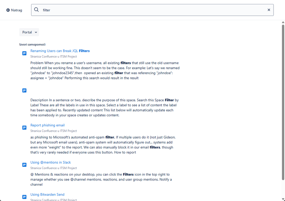

Could you also confirm whether the only way for customers to filter articles is by labeling each article with keywords — and that these keywords must be created and assigned by the administrator? Or is it possible to select labels independently, based on how the filtering system works with the web algorithm?
As for this, it depends. If we are talking about customer search, in the help center—those users cannot filter by anything other by keywords or phrases, which are then searched through KB titles and content. Basically, they cannot filter by labels.

As for this, it depends. If we are talking about customer search, in the help center—those users cannot filter by anything other by keywords or phrases, which are then searched through KB titles and content. Basically, they cannot filter by labels.That actually reinforces the need for having two separate Knowledge Bases in German and English.
Since customers can only search using keywords or phrases—and not filter by labels or categories—this creates a problem: if a client searches for an English keyword (e.g., “ticket”), and that same word also appears in German articles, the search results will include articles in both languages.
This means the client will be forced to browse through content in a language they don’t speak or aren’t interested in.
The core issue is that there’s currently no way to restrict search results to language-specific content or to link a specific Knowledge Base to a specific Kontakt form in a specific language. Even if we create separate forms, we can’t guarantee that the articles suggested will be only in the appropriate language.

  • JSM allows you to provide help in multiple languages, but you'd probably link only one Confluence space (KB) language per service project.
  • Customers cannot filter KB search results by language; search returns articles from all languages in the linked space.
