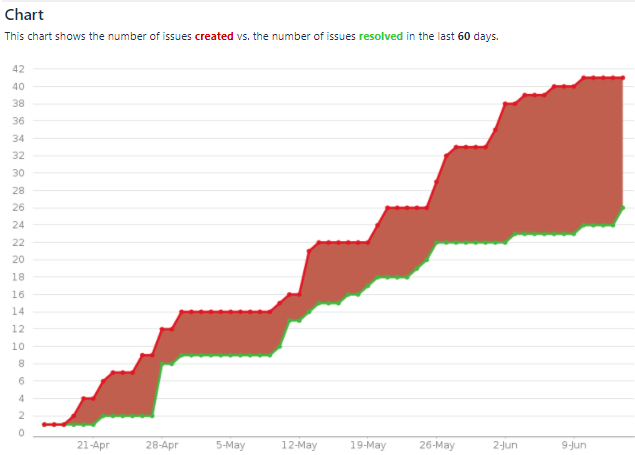

Just to be sure my request is clear: I want to have "Created vs Resolved Issue Report", which you can see in Jira Software, on Jira Software Management. Are you sure your doc is correctly guiding me to my request?
The image you provided certainly appears to be the gadget that Alexis is referring to. Note you can create a created versus resolved report in your project as well you desire. However it will appear a little bit different in that it doesn’t do shading between the two lines.

Hi @Andreas Johann Kutta , your resolved line can go above the created line for sure. That is a very good thing as you want to stay ahead of the curve. What you should see if your team is doing well is a green shaded area indicating that the team is resolving more issues than what has been recently created. Remember that this is a timeline view so there could have been an time where a lot of issues were created, indicated by a red shaded area, but then your team begins to catch up indicated by a green shaded area. Feel free to share your screenshot if you have further questions.

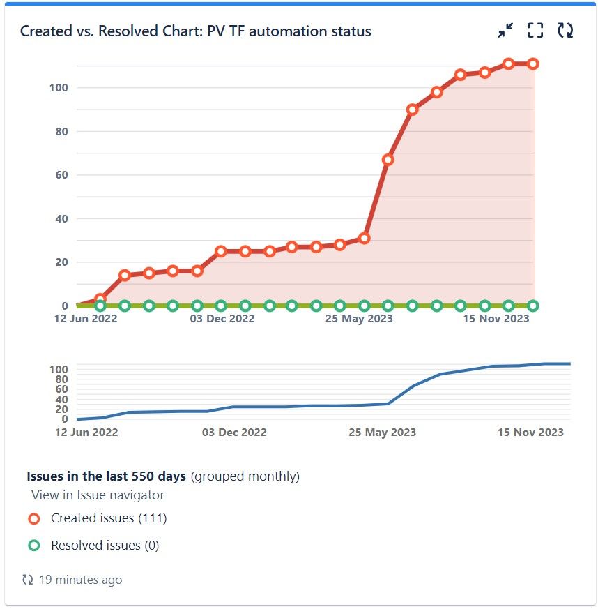

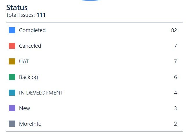

I have a question about the criteria of resolved ticket. I would like to know what status of ticket will be recognized as resolved?
Here is my chart there is no tickets have been determined to be resolved.
However, there should be 82 tickets have been completed.
Thanks, and regards,
Anndy
Hi @Anndy , are you setting the Resolution field when moving an issue to the Done statuscategory? That needs to be done.
Hi @Jack Brickey , thank you for the answer, I got the point now. The workflow of this project set to end by 'Completed' statuscategory, it looks like we have to change it.
Hi @Anndy , to be clear there are only three status categories: To Do, In Progress, Done. Each status that you create will be assigned to one of the three categories. I assume your "Completed" status is assigned to the Done category? My earlier response conveyed that you need to ensure you set the Resolution when you transition to Completed.

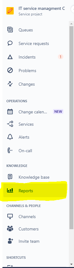

Hello @Riki YAMASHITA
I see you are using JSM
Go to your JSM project choose reports on the left side menu, Created vs Resolved is already there.
BR, Olga
Yes but it is only showing the number per day. I want to see accumulated number of the tickets.
