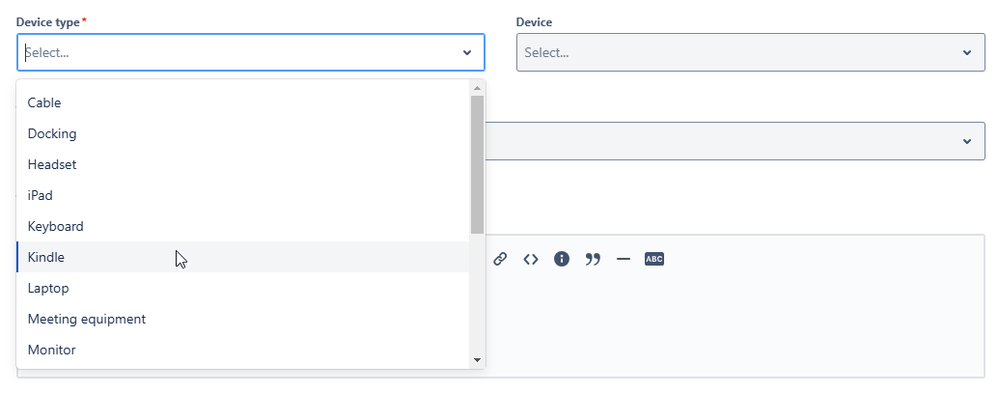

To select specific equipment/assets and raise a ticket connected to that asset, users do not need to have a JSM license.
For example, you can display (and filter out) objects from the specific schema for Jira Service Management customers to select when submitting a specific form. In the following example, you can see how specific objects as displayed in a custom field that is visible to customers
which is in fact Assets custom field.
