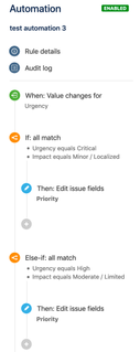

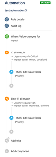

You can create two automation rules (Under project settings > Project Automation) that should be triggered when either one of the fields (Impact or Urgency) are filled, however, using conditions that only apply the priority update if both fields are filled with specific values. Check below two examples:
Screen Shot 2020-03-24 at 18.02.56.pngScreen Shot 2020-03-24 at 18.03.36.png
Using the rules above, the automation will be triggered whenever the Urgency or Impact are filled, however, it will only add any value to the priority field when both fields are filled, where you should be able to create different combinations to define the priority field.

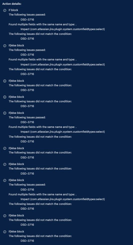

@Petter Gonçalves -- Hoping you can assist me and I can append to here as its a similar issue. I'm not able to successfully run a variation of this rule (urgency/impact are required values, so the rule runs on issue creation). However, the only useful information I had in the audit logs was this:
Initially, there were 2 custom fields named "Impact". I renamed the other field to avoid this and reattempted, but with the same message in the logs. But perhaps this is becuase there is a background indexing still occurring?

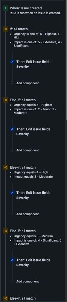

Here is part of my rule automation. when testing, I used Urgency: 5 / Impact: 5, which should be captured in the first If block.
