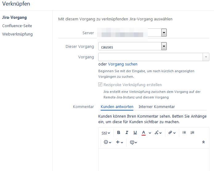

If I try to link the JSW-Issues to JSD-Issues in JSW I find the JSD-Project. However an error message is shown that link cannnot be created because there is no authentification configurated.
Simon Kälberer
July 19, 2018
Trying to link issues from JSD to an existing Issue in JSW works. But I cannot not create an linked JSW Issue out of JSD.

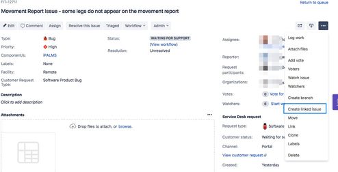

Below is what you should see or similar when you click on the ellipses in the top right when viewing the issue. This is from Cloud so if on Server it may be a bit different but it will be close.

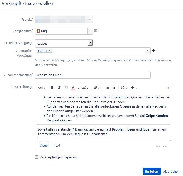

we use server. JSD and JSW however are installed on different VW. What I don't get is that I can link an JSD Issue on an existing JSW issue. But I am not able to create a new linked issue.
I have uploaded some screens. If I am creating a link to an existing issue I can switch server and select an issue in JSW. If I am creating a linked issue this option is not avaiable and I can only choose a project in JSD.
