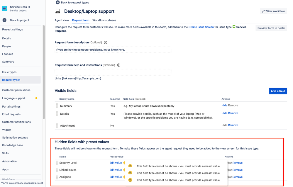

If it’s a company-managed project (classic), go to Project settings > Request types. Click on the affected Request type > Request form and check if the hidden fields have correct values.

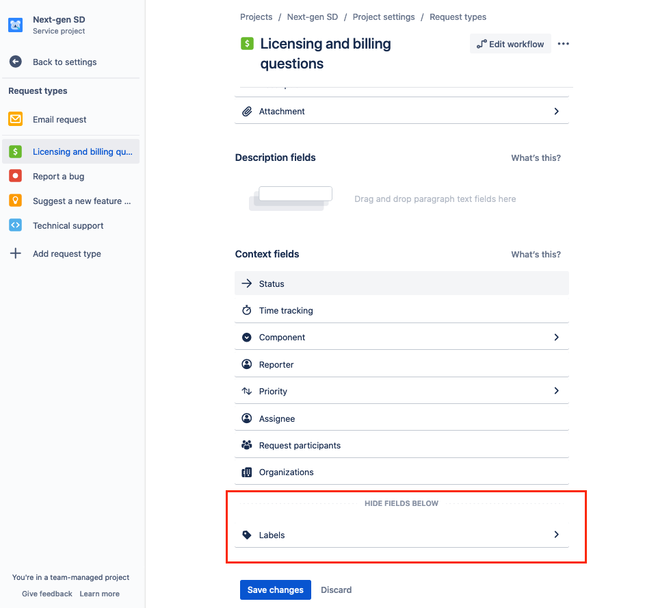

If it’s a team-managed project (next-gen), go to Project settings > Request types > Select the request type and check the hidden fields.
If everything is correct with the Request type, can you please open the developer tools on your browser while creating the ticket and check on the console tab if it shows any other error?
If so, can you please send us a screenshot? Just make sure to hide private information.
